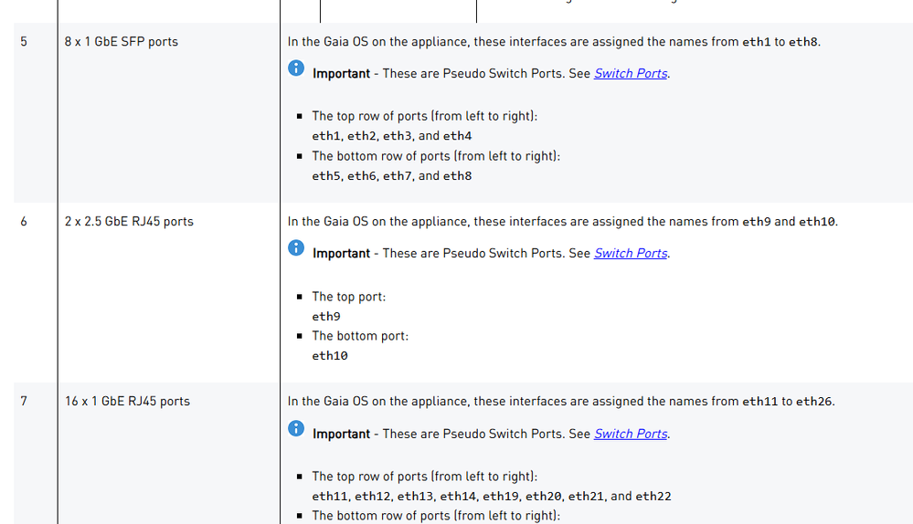

Its listed with switchports in the hardware document.
https://sc1.checkpoint.com/documents/Appliances/GSG_3900/EN/Content/Topics-GSG-3920-3950-3980/Applia...
Also here.
I thought initially its a beefed up SMB, but looks way better than that.
