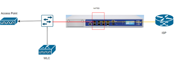

Hello CheckMates,
We suddenly have issues on our CheckPoint Firewall 4800 going out to internet.
It is a WIFI to our Guest and I have check the Switch, APs, WLC and our Modem(Direct connection is working)
We are associated in our WLC and it was even to provide us an IP address from WLC.
The issue is that the WIFI logo is showing with ! using our mobile
Troubleshooting Done.
1.) Reboot AP
2.) Shut/Unshut ports on switch
3.) Adjust Power Level
4.) Turn off/on the SSID
5.) No Changes on VLANs/WLC on the switch
6.) Direct Connection in the ONT – Working
Here is the result when doing a ping test to 8.8.8.8, btw we have a spare same firewall but same issue

What host is generating the Destination Unreachable message?
That generally means it doesn’t have the necessary route.
How is the default route defined on the 4800?
What version/JHF is running on the 4800?
It is intermittent, it can ping destination and mostly it will result to host unreachable.
Interface eth2 10x.x.110 /30
set static-route default nexthop gateway address 10x.x.x.109 priority 1 on
set static-route default nexthop gateway logical eth2 priority 1 on
This config is being used since 2018 then few days ago we experience an issue on our guest wifi.
Our version is using Check Point R75.4

Hi,
I will remove the following config
Then leave the remaining config
How do I clear the ARP cache using a cli config?
Thanks
First of all, when you remove the route, the arp cache being full should no longer be an issue, assuming there is an ARP entry for the default route.
Second, I don't believe there is a way to clear the arp cache, but it should clear on its own.
I will remove the config then hopefully it will fix the issue.
I am new using checkpoint, what is the command to remove set static-route default nexthop gateway logical eth2 priority 1 on?
Thanks
Hi All,
Removing set static-route default nexthop gateway logical eth2 priority 1 on able to resolve the issue of destination host unreachable.
Thanks for all the help!
This one have a NAT config from the smart console.
I am still figuring out how to access it.
Basically,
The guest user segment is 192.168.10.0/24
All the wifi client will be natted to ip 10x.x.x.110 when accessing internet
