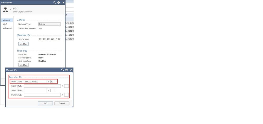

Hello. I am studying in a laboratory environment and I have a question. In the topology of the image I have a clusterXL already configured. My LAN interfaces are OK working with VIPs. My question is in the WAN connection (eth3) with my 2 ISPs. Is it possible to keep the eth3 interface connected with ISPs outside the cluster? In SMAR CONSOLE in the cluster properties I can't add the eth3 interface to stay out of the cluster.

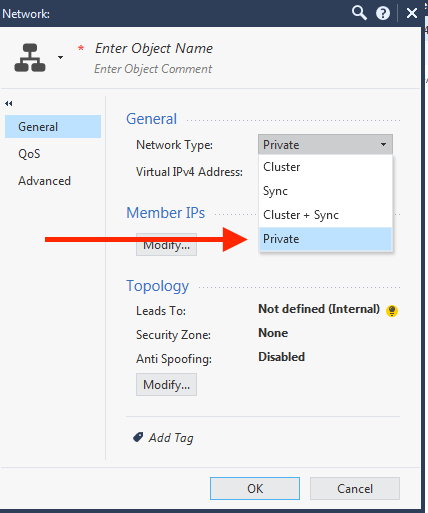

Of course you can, just mark it as private

This would be an unmonitored interface, which is possible.

Hi Val. Thank you very much. I even selected the PRIVATE option, but I thought I had to enter the IP addresses on the 2 secure gateways. Thank you, as it is already working here.
