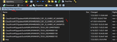

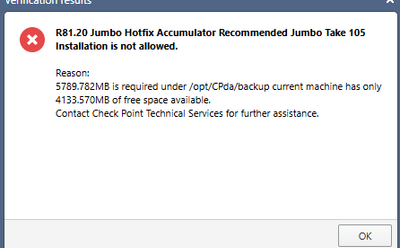

I’m currently running Hotfix 98 and planning to upgrade to Hotfix 105. During the package verification, I’m getting an error related to insufficient space in the /opt/cpdabackup/backup directory.
Could you please confirm if it’s safe to delete the oldest backup file (in this case, the first one in the list) to free up space and proceed with the upgrade?

Yes, its 100% safe.

Yes - upgrade tools and old Jumbos are not necessary! You should be able to remove the tools using cpuse. For Jumbos:
- uninstall ALL Jumbo Takes
- upon reboot, delete them all in cpuse
- install last take
