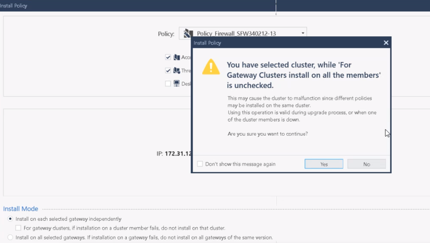

Install the policy on the upgraded member. However, before doing so, go to the Cluster General Properties and change the cluster version to the new version that is being installed.
When installing the policy, disable the option that attempts to install on both members and stops if one fails. Instead, force the cluster to attempt installation on both members. The installation will fail on the outdated member and succeed only on the upgraded one.
After that, manually bring the down member up using:
clusterXL_admin up
Enable Multi-Version Cluster (MVC) on the firewall that is now running the new version (for example, R81).
In Expert mode, enable MVC.
This will allow the member running the new version to communicate in the cluster with the member that is still running the old version, so the upgrade process can continue.
Then go to the Cluster Properties again and change the version to R81 (or R81.10), and proceed with the Install Policy using these settings enabled.
NOTE: If was a cluster, this is a important step, because will install on the member that its high version, and failed the installation in the old, because during the upgrade process of a cluster this is required step
Or if you are upgrading a normal gateway this is required too.
Note: Uncheck the option “For gateway clusters, if installation on a cluster fails, do not install on that cluster.”
This will allow you to install the policy on the newly upgraded member. The installation will fail on the member still running the old version, but this is expected behavior.

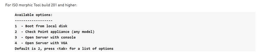

When the firewall detects the USB drive, it will display a prompt similar to the following (for UEFI-based appliances):
Select option 2 – Check Point appliance (any model).
