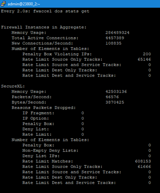

There is a feature to track packet rate per source IP to prevent fails positives.  When the feature is enabled the same traffic profile doesn't trigger any drops because per-Source rate is much lower. The screenshot below shows a lot of matches for the rate limit rules and 0 drops because the traffic is coming from 61K source addresses.
