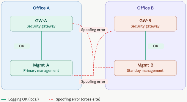

  • Two geographically separated offices: Office A and Office B
Topology
Issue description
Log forwarding works correctly when traffic stays local:
  • GW-A → Mgmt-A: OK
  • GW-B → Mgmt-B: OK
However, as soon as a gateway sends logs to the management server in the other site, an address spoofing error for FW_Log is triggered:
  • GW-A → Mgmt-B: Spoofing error
  • GW-B → Mgmt-A: Spoofing error
The root cause appears to be that each gateway uses the same source IP regardless of which log server it targets. When the log packet traverses the inter-site link and arrives at the remote gateway, the source IP belongs to the wrong network segment, causing the receiving gateway to flag it as spoofed.

Is there a supported method in R82 to control the source IP a gateway uses when sending logs to a specific log server?
For example, GW-A has multiple interfaces. When it sends logs to Mgmt-B across the WAN, is there a way to tell it to use a specific interface IP as the source — similar to how you can pin a source interface for other connections?

This looks like an asymmetric routing issue on the network path between A and B.  You can also update the incoming interface on each gateway to "not check packets from" ... and select a group object containing the gateway in question.
When FWD fires up and initiates the connection to the log server, it binds to the interface closest to said gateway.  It will use this interface until FWD is restarted.  This will explain why the source is always "that" IP on the gateway. There's also a logging_worker process in (at least R82.10) that I believe handles the log forwarding when gateways become disconnected.
If you can afford it, and you can induce a log server failover, SSH into the problematic gateway and restart FWD manually to see if the source IP changes on a new process.  That'll give you the answer.  Then do the "don't check packets from" config.
