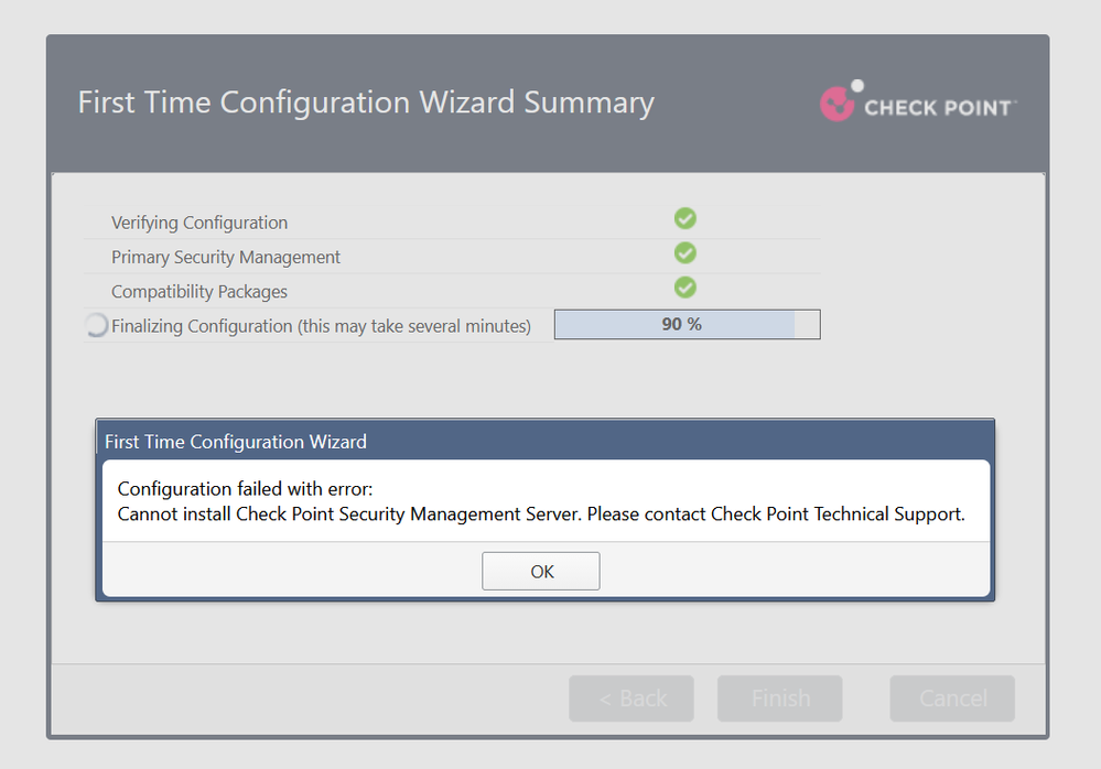

I am testing the installation of a Check Point SMS on Proxmox. However, every time the First Time Wizard reaches 90%, it fails, as shown in the attached screenshot.
Any idea what that would be for error? maybe it is Linux error ?
disk is 200GB
8 CPU
12GB memory
Late last night, I switched the network device from virtio to e1000, and it's working fine now. As I suspected, there seems to be a Linux-specific issue causing the installation to fail. I'm not sure if my lab environment requires e1000 specifically, though.
I encountered similar issues with a Check Point R82.10 cluster in another lab; the sync traffic would work for a few minutes and then crash. I’ll start a separate thread about that once I have that environment up and running again.

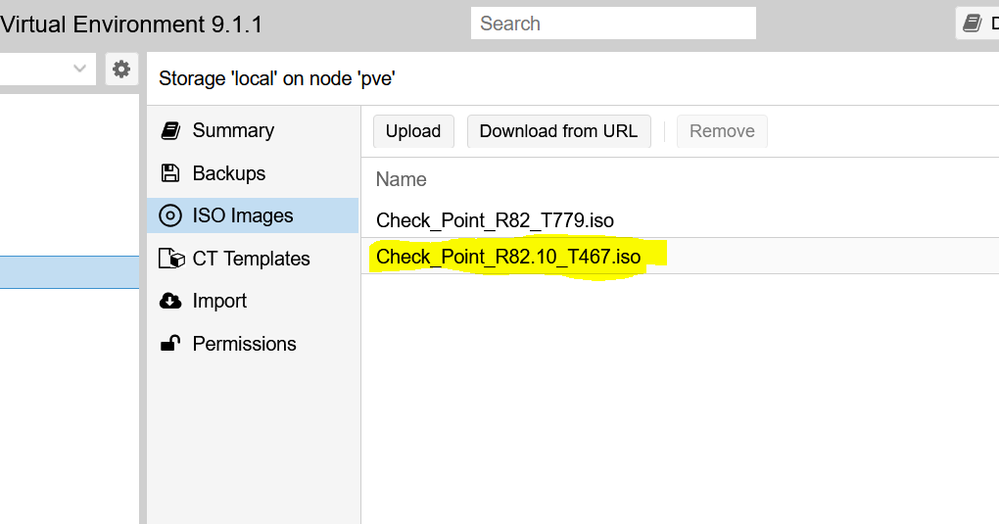

did you picked the correct image? https://support.checkpoint.com/results/sk/sk158292
I am using this one:
ISO looks good, can you check this sk?
https://support.checkpoint.com/results/sk/sk115613
R82.10 is not on that link but i wiil try it and get back
ls -la /etc/.wizard_accepted
-rw-r--r-- 1 admin config 0 May 16 15:34 /etc/.wizard_accepted
[Expert@A-SMS:0]# tail -n 10 /var/log/ftw_install.log
psql: error: connection to server on socket "/tmp/.s.PGSQL.5432" failed: FATAL: password authentication failed for user "postgres"
Cannot install Check Point Security Management Server. Please contact Check Point Technical Support.

What other hardware and options do you have configured? This is my config, it clean installed with no issues.
