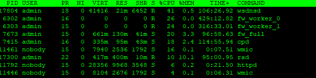

I'm having issues with a 4200 appliance and it's performance. While these issues have been going for a while, they are becoming quite disruptive lately.
The setup is a 4200 appliance running R80.10 (but also R77.30 had these issues), with only the Firewall, VPN, Identity Awareness, Application & URL filtering blades enabled. The problem is, I have no clue as to what's causing this and my troubleshooting skills are not up to par. I hope you can give me a clue.
More often than not, I see the gateway's CPU peak to 99%. Sometimes, when I check the top connections with cpview, I see a client downloading a file over https (inspection not enabled) with 60Mbit/s over our WAN connection. While this, in my opinion, shouldn't cause a gateway to max out, I can understand. But other times, I see no visible clue as to why this is. I will hardly see any traffic in cpview, but 'top' gives me an output like the one below.
This is not always the same. Sometimes you see a fw_worker, cpd or pdpd as the #1 CPU user.

From memory 4200 has only two CPU cores. Doing simple maths from your screenshot it adds up to 165%. It does not show soft interrupts for SXL. So that would take some usage too. I'm just guessing that your CPUs are maxed out. Check with top (option 1) so you see both core utilisation in detail when it happens. How much idle time you see left on each?

Kaspars Zibarts I'm also guessing the CPU is simply maxed out here. That would explain the high percentages of CPU usage for "less obvious" processes I guess?
Turning off AP and IA is not really an option right now, as this has too much impact on the environment. I could try to disable URLF.
You can see that SXL (traffic arriving on interfaces) is chewing a lot too
therefore you don't have much CPU idle time left there. So my guess would be that these gateways would struggle to cope with slightest traffic peaks due to CPU time shortage. You need to get bigger boxes
You also mentioned that you might be running R80.10 on those. I know 4000 series are supported, but bear in mind that R80.10 is much more CPU and memory hungry compare to R77.30.
Do you have any monitoring tools in place to see CPU history per core? Else just check manually (if possible) when it becomes unstable / unresponsive - see how much idle time is left.

Thanks for the help guys. I'm going to look into monitoring the individual cores. We have monitoring in place for general CPU usage but upon further inspection, that's doesn't prove to be very useful. Also, the main issue is spikes. Generally speaking, the performance is "okay" (as in, CPU could be consuming 90% but users are not yet affected), until something happens, like a download or a sudden higher amount of connections. The whole thing comes crashing down in flames.
The monitoring hardly ever picked up on these spikes. I'll look into the OID's
For now, I have switched back to R77.30, this helps, although we're still very close to the limits of the gateway.
Back to the drawing board, and wait until someone spends the money on "bigger boxes". ![]()
