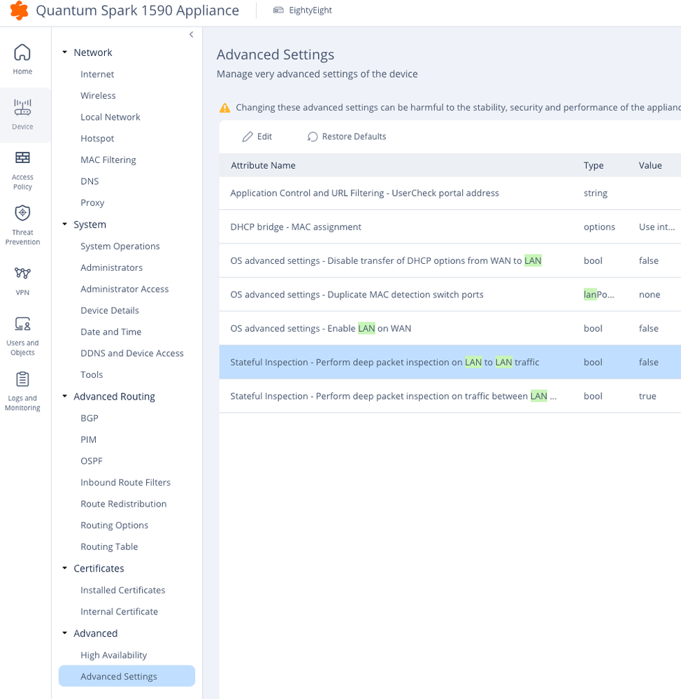

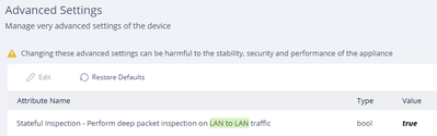

There is a hardware-level switch involved on the Quantum Spark appliances.
That traffic isn't typically inspected, but you can enable this function (with a performance impact):
Hi @PhoneBoy,
Thank your for your reply.
I admit that I completely forgot to take a look at Advanced Settings ... 🙂
Unfortunately this option that you mentioned, and also some other that I checked (ex. "OS advanced settings - Enable flow-control for network switch") ... doesn't change the situation.
I still see no packets that go from one interface to another inside a switch.
But as you mentioned as it is a hardware switch ... it seems that I will not achieve this goal.

I completely understand the need/desire for this 🙂
Did you try using fw monitor to check this traffic after enabling this option?

It was worth a try.
However, it does make me wonder how that Advanced option works...or if it still does.
To be honest ... the same from my side 🙂
I was thinking that maybe it works as the name suggests .... so if enabled it will inspect traffic from LAN 2 LAN ... but no, it's not working like that.
Simple example gave this answer - rule on top of incoming rules (local management) where source and destination is 10.99.99.0/255.255.255.0, service is icmp and action is block.
With such a rule if we will have inspection between LAN and LAN ... it should block ping.
Of course ping is working.
Sure, this example had no sense at all ... because if there is no visible traffic in tcpdump/fw monitor between host in this network ... such a rule will just be nonsense .... but as you wrote "It was worth a try" 🙂
To to summarize this discussion - it looks like there is no way ... and I have to accept this that this is hardware switch and period 🙂
But still .... too bad ...
