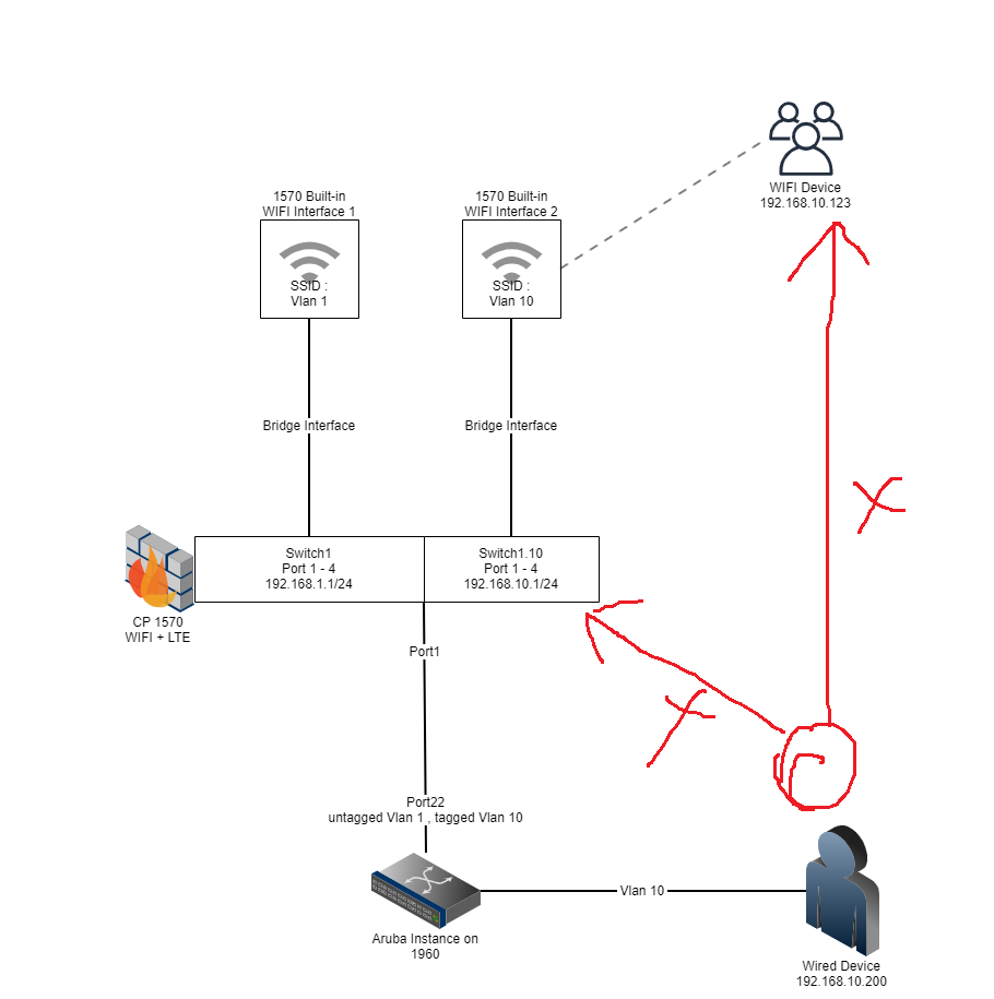

Let's make it simple.
My wired user can not access the Checkpoint Vlan 10 interface or the VLan WIFI as below.
While I appreciate the network diagram, I believe screenshots of exactly what you've configured would help.

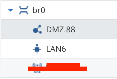

While I don't have the exact configuration, I have done something similar in the past and the following should work:
In my case, the "VLAN Tagged" port is the DMZ port (i.e. what would be connected to the Aruba in your case).
The DMZ port is not assigned to any switch or bridge.
In your case, according to your diagram, that means LAN1 should be unassigned, but LAN1.10 should be assigned to the bridge.
