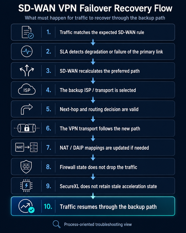

2. The SD-WAN Failover Chain
For a VPN tunnel over SD-WAN to survive a link failure, several things must happen correctly:
If any step fails, the symptom can still look like:
"The VPN tunnel dropped.”
But the real root cause may not be VPN.

16. Practical Troubleshooting Logic
When a VPN tunnel drops after SD-WAN failover, I usually follow this logic:
1. Did SD-WAN detect the link failure?
2. Did the expected SD-WAN rule match?
3. Was the backup ISP considered healthy?
4. Was a new transport or next-hop selected?
5. Did VPN try to use the new transport?
6. Did NAT / DAIP mapping change correctly?
7. Did the firewall drop packets due to state, NAT or asymmetry?
8. Did SecureXL preserve stale state?
9. Did new flows work while old flows failed?
10. Did the SD-WAN internal tables match the expected configuration?
This avoids jumping directly to “VPN is broken”.

18. Final Thought
In SD-WAN, a VPN tunnel dropping after link failure is not always a VPN problem.
It can be:
SD-WAN rule matching
SLA detection
steering decision
transport selection
routing
NAT / DAIP mapping
CP gateway state
firewall connection state
SecureXL acceleration
VPN negotiation
The goal is not to prove only that the link failed.
The goal is to prove the full chain:
That is the difference between troubleshooting a symptom and troubleshooting the SD-WAN architecture.
