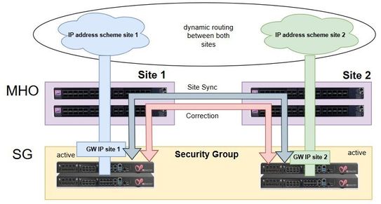

Hi @emmap,
If I understand correctly, each site will have its own IP address scheme.
Within a security group, each site will have its own IP address on each interface of the security group.
Traffic between site 1 and site 2 will be routed through a dedicated internal network.
Incorrectly sent packets will be forwarded via a correction layer.
For the forwarding of IPs between site 1 and site 2, dynamic routing will likely be used.
Can it be visualized schematically like in this picture?
Is that correct?
The dynamic routing would be up to and across the surrounding network devices. Between the MHOs directly we just have site sync, like any dual site deployment. The two sites don't form routing adjacencies directly with each other.
It's basically like two separate single site deployments, only with state sync and correction.

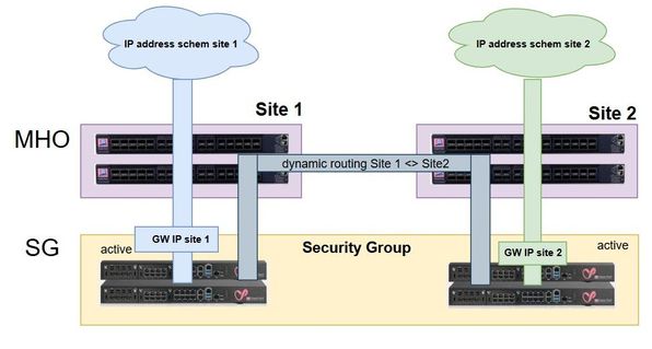

Ok, then it would look more like this. The dynamic routing takes place between the different IP pools on both sides.
Yes that's more a more accurate picture for it.
THX @emmap,
I will include the image like this in the original article.
