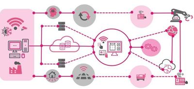

Figure 1: Example overview of OT assets
Reassessing OT Cyber attacks
OT (Operational Technology), Industrial networks or ICS (Industrial Control System) networks are completely different to IT networks. OT environments have other requirements and needs compared to IT environments. Below and overview of the differences between those 2 worlds.

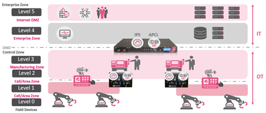

Figure 2: Overview IT vs OT requirements

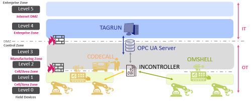

INCONTROLLER (aka PIPEDREAM) | ICS attack toolset which allows communication, access and manipulate Schneider Electric, Omron PLCs and OPC assets. It can manipulate PLCs and industrial software. It is very likely state sponsored. Offering capabilities related to disruption, sabotage and potentially physical destruction. The toolset consists of:
1. TAGRUN - Is a tool that scans for OPC servers, enumerates OPC structure & tags, brute forces credentials and read/write OPC tag values
2. CODECALL – Is a framework that communicates via Modbus, the most common industrial protocol and Codesys. CODECALL contains modules to attack at least three Schneider Electric PLCs.
3. OMSHELL – Is also a framework with capabilities to communicate and scan some types of Omron PLCs via HTTP (port 80), Telnet (port 23), and Omron FINS protocol (port 9600).
- Target | Energy facilities
- Risk | Disrupt and shutdown operations, reprogram PLCs to sabotage industrial processes and disable safety controllers to cause physical destruction
Figure 6: Incontroller/pipedream infographic ploted on Purdue model

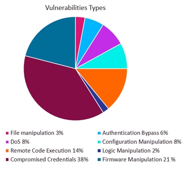

OT:ICEFALL | Forescout researchers released a report about 56 vulnerabilities caused by insecure-by-design practices in the OT realm. The vulnerabilities are divided into four main categories:
1. insecure engineering protocols
2. weak cryptography or broken authentication schemes
3. insecure firmware updates
4. RCE (Remote Code Execution) via native functionality
- Target | oil and gas, chemical, nuclear, power generation and distribution, manufacturing, water treatment and distribution, mining and building automation.
- Risk: exploitation of security flaws, which can lead to:
- RCE, Remote Code Execution
- Compromised assets (bots or zombies can participate in DDoS attacks)
- Corrupt and exploit vulnerable firmware
- Credential theft
- Poor authentication or bypass authentication
Figure 7: Overview of Icefall vulnerabilities

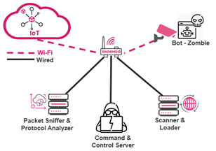

RSOCKS Proxy Botnet | This Russian botnet is dismantled by the FBI. The compromised assets (350.000 devices), bot or zombie were sold as high quality proxies. The threat actor mechanism is similar to Mirai, exploiting known vulnerabilities and weak credentials. Under compromised assets there were OT assets and consumer assets.
- Target | Industrial control systems, IoT devices and much more from PCs to Android devices
- Risk | Compromised assets may participate in malicious activities such as DDoS
Figure 8: Overview of RSOCKS Proxy Botnet
