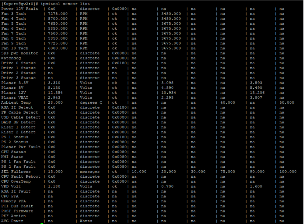

You can query all sensor data of the server via SNMP.
This should be possible for all values that you also see with "ipmitool":
# ipmitool sensor list

Nothing in the case of an HP DL360/380 gen8/9
Could not open device at /dev/ipmi0 or /dev/ipmi/0 or /dev/ipmidev/0: No such file or directory
Get Device ID command failed
Unable to open SDR for reading
[Expert@fw]# raidconfig status
-- Controller Information --
ID MODEL
-- Arrays information --
ID Type Size State
-- Disks information --
ID Model Size Status
