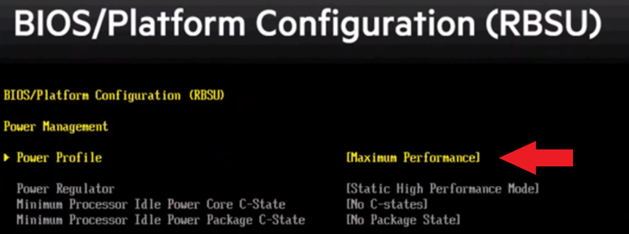

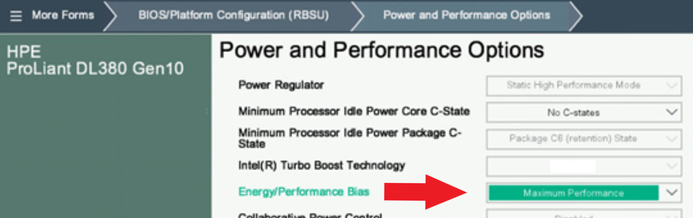

What I see again in practice is that the servers are not set to maximum performance in the BIOS. This means that the processors and menory are not running at full power. This can be quickly changed with a simple BIOS setting. Here an example for a HP DL 360/380 server.
Example for HP DL 360/380 G10:
Example for HP DL 360/380 G9:

On the HP DL360G10 servers i gotten the last months, then the BIOS is updated so the options do not look the same.
Have you have time to check the new bios?
Now its instead workload profiles, am not sure if you have checked these.
But more or less it looks like you need to run custom to be able to turn off intel turbo speed.
And there is alot more options then before, no longer just changing to max perf.
Yes this is true that the new BIOS has changed some settings significantly.
