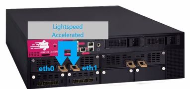

Only traffic on the same NVIDIA network card can be accelerated by Lightspeed.
Network traffic between different network cards cannot be accelerated by Lightspeed (uses regular flow and speed).

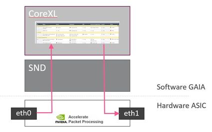

1) First packet in every connection validated by security policy check in the CoreXL instance.

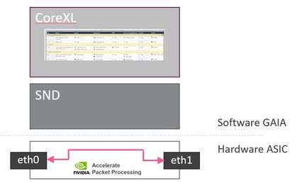

2) Approved traffic flow offloaded to Quantum Lightspeed ASIC via rte_flow API
3) Subsequent packetes are secured by accelerated packet processing via NVIDIA ASIC

We plan to use Lightspeed applications in the data centre in the future. Can the traffic also be accelerated between two NVIDIA network cards through Lightspeed?
HeikoAnkenbrand
MVP Diamond
MVP Diamond
Hi @Rasputin,
Lightspeed optimization is not possible between two NVIDIA network cards.
For acceleration, both 100Gbps interfaces must be on one network card.
