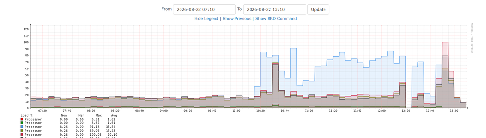

Also , since we did as requested by Checkpoint and changed the Identity Awareness to listen to ALL Interfaces I started having some HUGE issues with connectivity trough firewall once in a while..one of the CPU spikes so high that the active node becomes unresponsive and my hypervisors start having packet loss and problems reaching quorum.
So today I was forced to revert back to Internal Interfaces only.
