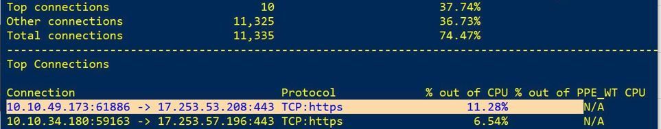

Hi
How is it possible that just two iPads are utilizing about 18% of the CPU on our 6500 appliance?
so, 10.10.49.173 and 10.10.34.180 are IPads and CPU usage is about 18%
These iPads were definitely downloading the latest upgrade, but what if all the other iPads did the same simultaneously? We have around 3,000 iPads on our network!
How about the idea of using SecureXL Fast Accelerator for all traffic to and from Apple, for example?
Depends what blades are enabled on the fw and if you do https inspection?
What download speed are they getting via the firewall? You can see this also in cpview
Third fast accel you need to add rules based on IP so example:
Source: 10.10.49.0/24 (i pad network) destination should be any, since apple uses cloud service you cannot add 1 IP and then port 443
I assume more device are in 10.10. and therefore you don't want to whitelist based on this. In order to whitelist you need to stop inspection on the traffic, so no more IPS etc. So long story short fastaccel is more for internal traffic like backup that you do not want to inspect. In this case i don't think it is a good solution.
All blades are active.
The IPad network is 50Mb speed, using a limit object
I don't know exactly how fast accel works but my thought is to have source our IPad network for example 10.10.0.0/16 and destination 17.0.0.0/8, something like that?!

This depends on the download speed. One connection sticks to one core. Do you have information about this connection? How much traffic was generated by one iPad? Mainly througput?
The Fast Accel sk is this: https://support.checkpoint.com/results/sk/sk156672
If you set a Fast Accel rule, this traffic will be load only the SND-s -> so there could be a bottleneck.
Dynamic balancing is enabled on this gateway?
However the best way would be that, the iPads do the downloads out of this gateway

To have a meaningful discussion about how to resolve this, we need to see Super Seven output: https://community.checkpoint.com/t5/Scripts/S7PAC-Super-Seven-Performance-Assessment-Commands/m-p/40...

| 8| 6| 60| 35| 65| ?| 1208974|
Processors load
|CPU#|User Time(%)|System Time(%)|Idle Time(%)|Usage(%)|Run queue|Interrupts/sec|
| 1| 0| 15| 85| 15| ?| 5078253|
| 2| 4| 56| 40| 60| ?| 5078256|
| 3| 4| 63| 33| 67| ?| 5078258|
| 4| 5| 52| 43| 57| ?| 5078255|
| 5| 0| 16| 84| 16| ?| 5078253|
| 6| 4| 50| 45| 55| ?| 5078249|
| 7| 2| 61| 37| 63| ?| 5078250|
| 8| 2| 59| 40| 60| ?| 5078180|
Processors load
Processors load
| 1| 0| 16| 84| 16| ?| 235636|
| 2| 5| 65| 30| 70| ?| 235644|
| 3| 7| 60| 33| 67| ?| 235642|
| 4| 6| 59| 35| 65| ?| 235642|
| 5| 0| 15| 85| 15| ?| 235641|
| 6| 7| 57| 37| 63| ?| 117822|
| 7| 5| 60| 35| 65| ?| 235644|
| 8| 5| 61| 34| 66| ?| 235640|
| Thanks for using s7pac |
You can also check my other post about performance:
https://community.checkpoint.com/t5/General-Topics/VPN-disturbances/m-p/226354#M37793
usnig the command: fwaccel templates -R
Matched connections not allowed to use templates:
% Prevention : 1.281%
Reason Count Reason Prevented From Matched %
Non-Syn/Empty First Packet |267373 |0.802 %
Src/dst IP Blacklisted |159739 |0.479 %
Dynamic VPN Connection |2 |0.000 %
Connections failed to create templates:
% Fail to Create : 78.011%
Reason Count Reason Fail To Create %
NON TCP/UDP PROTO |4714670 |1.098 %
Conn Not Accelerated |9176797 |2.137 %
NAT Disallowed Conn |47721578 |11.114 %
DHCP Check Feature Isn't Supported Or Disabled|10 |0.000 %
General Error |986319 |0.230 %
Malicious Destination IP Detected |270268 |0.063 %
Prevented By Policy Rules |272080388 |63.368 %
Prevented By Policy Rules is decreasing steadily but very slowly, about 2% per day
same is true for "%Fail to Create" also decreasing steadily but very slowly
So, i wonder why Accelerated conns/Total conns still 0%
What does this command say: fwaccel dbg -m general + template
fw01> fwaccel dbg -m general + template
fwaccel_dbg_get_module_by_name: ERROR - unrecognized module name: 'general'
Unknown module 'general'
fw01> exp
fw01> expert
Enter expert password:
Warning! All configurations should be done through clish
You are in expert mode now.
[Expert@fw01:0]# fwaccel dbg -m general + template
Yeah, this likely needs the full debug procedure, which is…a bit more complicated.
I strongly suggest involving TAC here.
