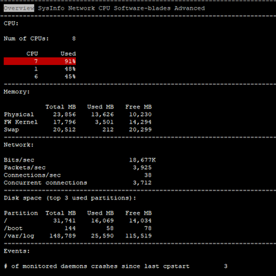

We have been experiencing intermittent performance issues that causes connectivity through the firewall to run slow. This particularly impacts accessing systems over Site 2 Site VPNs and Remote Access VPN. We are running CheckPoint 15400 R77.30 in ClusterXL active / standby. The firewall has IPSec VPN, Mobile Access, IPS, Anti-Bot, Anti-Virus, URL Filtering and Application Control features enabled.
Looking at cpview, the CPU spiked on a particular core and stayed high for 6 hours before returning to normal. This time frame correlates with when the issue was reported and resolved. This issue occurred during a low usage period so doesn't seem to be caused due to high traffic / connections on the firewall.
If anyone has any ideas, thoughts to resolve this issue, please let me know.

As @Chris_Atkinson said a serious limitation in R77.30 is that only one FW instance/worker can handle all IPSec VPN traffic, usually FW instance #0 which is on the highest-numbered core, which is core #7 in your case. There is not much you can do about this other than upgrade to at least R80.10.  sk118097: MultiCore Support for IPsec VPN in R80.10 and above
If you are stuck on R77.30 for the time being, you could set variable fwmultik_dispatch_skip_global from 0 to 1, which will dedicate the worker instance handling IPSec to performing only that function and not handling any other connections.  Enabling the Dynamic Dispatcher (sk105261: CoreXL Dynamic Dispatcher in R77.30 / R80.10 and above) will help keep the worker cores balanced overall, but will not help at all with the single-core IPSec limitation in R77.30.

If it happens again take a look at top or ps,  See if it's a fw_worker tread that is maxing out the cpu on that core.  My guess it's  an unaccelerated 'elephant' flow (cifs transfer?) over the vpn tunnel that's maxing out the cpu.
