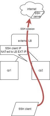

I attach a basic topology
\m/_(>_<)_\m/

A small clarification:
"It seems the connection does not sync to the standby member."
In case of manual failver (clusterXL_adn down), the packet flow is changed. The outgoing packet flow through the Active member, but the reply packets in this session flow through on the stanby member.
It cause assymentric route.

It sounds like you might be using the nic0 external IP for SSH. Could that be the case?
No, because I NAT to the external IP of the loadbalancer in VPC
