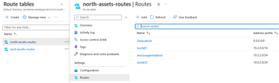

- Azure level routes --> In Azure Portal --> Go to Route Tables
- Edit the Route Tables for the subnets used in VPN Domain for both Gateways, in this case there are only two route tables as we have only a single test subnet in each Azure VNET
- On the Route Table properies, go to Routes TAB and add a new Route to reddirect traffic torward the other VNET’s subnet via the gateway’s eth1 private IP
- For the north-asset-routes, all traffic to west-webserver subnet assets will be reddirected via the north-SG eth1 interface IP
- For the west-asset-routes, all traffic to north-webserver subnet assets will be reddirected via the west-SG eth1 interface IP
