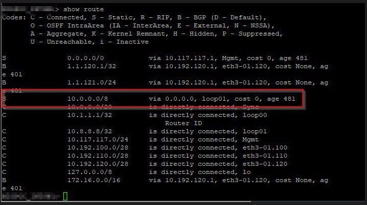

This 10.0.0.0/8 is the static route I would like to be distributed into BGP.

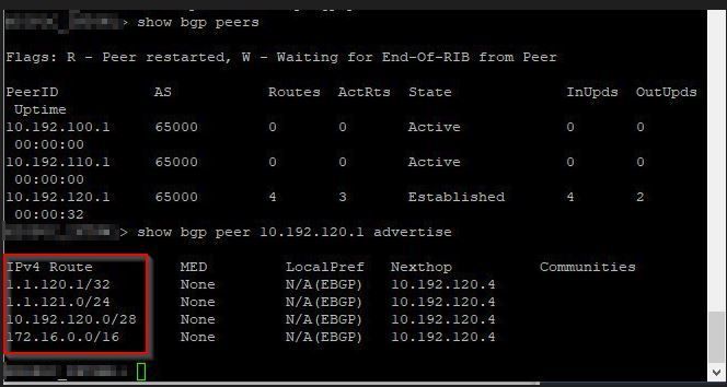

I dont see it advertised...

Works right away!  Now I see what you mean by it advertises everything including the sync interface...
