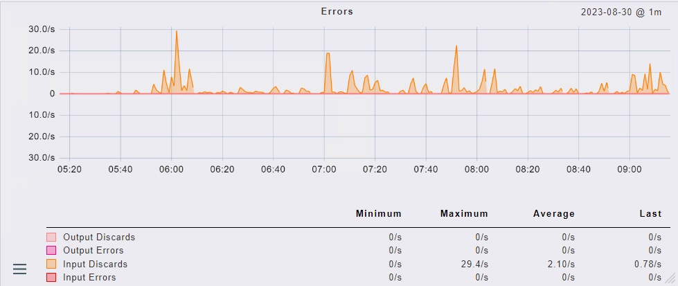

RX out of buffer drops on 25/40/100G (Mellanox) interfaces
After having an SR open for quite a while and doing a loop on same questions and suggestions for a few times, I’m slowly losing hope in getting anywhere near a logical explanation.
I would kindly ask if anyone is/was having the same “problem” as I am.
I’ll try to be short in the explanation:
After migrating from an older open server HW (minor SW change R81.10 JHF82 to JHF94)  from a 10G Intel i340-t2 copper to a 25G Mellanox Connect-X4, we started to observe RX drops on both bond slave interfaces (on the previous hardware it was 0). There’s not really a big amount of them (100 – 200 frames every 30s) but they are constantly increasing. (RX packets:710147729181 errors:0 dropped:11891177)
Details:
Connection: Logical Bond (LACP) 2x 25G
Implementation type: datacentre FW (only FW blade currently) with a 10/6 CoreXL/SND split. Most of the traffic is accelerated.
Accelerated pkts/Total pkts      : 1452240020060/1468567378332 (98%)
6 RX queues on the mentioned interfaces.
RX-ring size: 1024
Traffic rates: average: 1G - 2G, PPS 200 – 300K; Bond traffic balance is in average a 10% difference. Most of the traffic is on those 25G data interfaces.
CPU load: SND CPU cores: 10 – 25%
CoreXL CPU cores: 5 – 15%
No CPU spikes not even near 100%. Drops are observed on the 10 – 25% CPU load.

RX-DRPs are incrementing continuously...but in clumps of i.e. 500 - 1000 packets get dropped every 60s. They are not related to policy installs. (attached log and short drop statistics)
Regarding the defaults; my bad, I have gone over the configuration again and apparently while I have increased the RX-buffer on the 1G interfaces to 1024, I did the same for 25G without checking the default, which is as you said 1024....so, I'm on defaults on the 25G. Sorry for the misleading info.
But still, why do you think those drop happen? If we look at the CPU usage, it should easily handle the current packet rate and never go over the current RX ring size with the current coalesce timings. Unless my bond split over two physical NICs ( 2 x (2x 25G NIC)) is worsening the thing.

Daniel_
Advisor
As there are just RX-DRP but 0 RX-OVR it's IMHO not a CPU/hw-limit problem. The network sends packages to the system which are not related. Maybe not configured VLAN(s) on GAiA....

We have very similar problems with the 25G NICs from Mellanox.
We have had the high error rate since migrating to these systems.
However, the situation became significantly worse with the update to R81.20 and the associated update of the NIC drivers.
https://network.nvidia.com/pdf/firmware/ConnectX4-FW-12_22_1002-release_notes.pdf
Since then, after a policy push, we have had the problem of losing a number of applications in monitoring.
Case is pending.

Hello Timothy,
thank you very much for these tips.
We had a maintenance window yesterday where we tried out a lot.
Checkpoint itself pointed us to this SK: https://support.checkpoint.com/results/sk/sk180437
Since this unfortunately didn't work, we updated to the latest take (26), also without any improvement.
Then we looked at the balancing again and quickly reset it to default, which unfortunately didn't help either.
We also took another close look at the rx_err rate and considered whether a ring buffer change would help.
Since the error rate is well below 1%, we think that's fine.
However, we have noticed that the error rate on the passive is always higher.
So today we're going to investigate whether the switches are sending things that Checkpoint doesn't support or something like that.
Unfortunately, we still have our actual problem, which is that some applications fail after a policy push.
The fact that it is due to the bonds with the 25G cards is just a theory because we have not seen any problems on the bonds with the 10G cards so far (here the RX_ERR rate is always 0).
Best regards
Lars

When you say error rate do you mean RX-DRP, RX-OVR or RX-ERR?  Can you please post the output of netstat -ni and ethtool -S (interface) for the problematic Mellanox interface(s).  If it is truly RX-ERRs you are taking that is usually some kind of physical issue.  Are they clumping up during policy installs or constantly incrementing?  sar -n EDEV
If they are clumping during a policy install that might cause enough packet loss for sensitive applications to abort.  The suggestion above to set "keep all" will help rule out a rematch issue where the existing connection is not allowed to continue by stateful inspection after a policy install, but I doubt that is directly related to your Mellanox NIC issue.  Can you see if the dying application connection survives in the connections table after a policy install (fw ctl conntab)?  If it does but stops working anyway that could be something going on at the NIC level.  I also wonder whether the NIC is trying to do some kind of "helpful" hardware acceleration/offloading for certain connections that gets broken by a policy install?
What Transmit Hash balancing are you using for your Mellanox-based bonds?  Another thing to try is drop all but one physical interface from that bond (leaving a "bond of one") and see if that impacts the problem as I suppose it could be something with LACP/802.3ad.

Thanks.  Here are a few observations but it is unlikely that they are related to applications dying when you push policy.
1) Based on the ethtool and sar outputs, something in your network is regularly sending a Ethernet frame (probably some kind of broadcast) that contains more frame payload data than the 1500 MTU you are using.  This packet will be discarded by the NIC and increment the RX-ERR/rx_jabbers_phy/rx_oversize_pkts_phy/rxfram error counters.  Unfortunately there is no way to see what this packet is via tcpdump/fw monitor/cppcap as it is discarded at the NIC hardware level and there is no way to change that behavior on most NICs.  You'll need a specialized sniffer appliance with customized NIC firmware to see these errored frames.  For an amusing (but highly traumatizing at the time) story about how I found this out the hard way, see here: It's Not the firewall  It is possible that Intel NICs don't consider this kind of frame an error and happily accept it; I doubt this is traffic you actually care about.
2) You are using the Layer 2 XOR transmit hash policy for balancing between the multiple physical interfaces of your two bonds.  For Bond1 this default algorithm is working well keeping the physical interfaces relatively balanced; you must have a lot of diverse MAC addresses on those networks other than only the firewall and some kind of core/perimeter router.  However it is NOT working well for Bond2, which must not have a diverse set of MAC addresses present and/or be some kind of transit network, and the underlying physical interface load is imbalanced enough to cause problems.  Would highly recommend setting Layer 3+4 on Bond2 on both the firewall and switch side; probably wouldn't hurt to do it for Bond1 as well just to standardize your configuration.
3) The RX-DRP/rx_out_of_buffer counters appear to be legit full ring buffer drops and not unknown EtherTypes.  The drop rate is really low (0.044%) but does seem to be happening in clumps (not regularly) that may indicate big spikes in traffic load or a policy installation event.  I would suggest grabbing a copy of the netstat -ni counters prior to a policy installation, installing policy, and check them again.  Did any applications die, and was it correlated to an RX-DRP on a relevant interface the application is using?  Given how low the overall rate is I would find this highly unlikely, but it is worth investigating.  If this does indeed appear to be the case, this is one of the very very few cases where increasing the interface ring buffer size is justified, as you appear to have plenty of dispatcher/SND cores.   But the fact Multi-Queue is stopping short at 30 queues for these 25Gbps interfaces when it should be able to go much higher should be investigated first; however that may just be a hardware limit of the specific NIC similar to the Intel I211 interface's limit of 2 queues when using the igb driver which supports up to 16 queues.

Wow, first of all, thank you for going into such in-depth analysis with us. We had also already considered switching the Bond1 to a new Bond with 10G cards to test whether the problems would then go away.
LST
Contributor
Doubling the RX ring buffer brought the rx-drp to a standstill.
The rx-err continue to count up continuously.
During the policy push it was actually faster than usual.
The test with switching a bond to 2 *10G with Intel (same Cisco Nexus switch) brought no change.
Unfortunately, there are drp and err here too.
At least for us, the Mellanox SFP can now be removed from the list of suspects.
Checkpoint is currently analyzing the recorded data.
I will post here if there is a solution for us, even if it is a fallback to R81.10 Snapshot.
We are currently looking deeper at: https://support.checkpoint.com/results/sk/sk115963
Update:
After we installed a Hotfix on October 3rd we realise yesterday that it had nothing to do with the URL filter blade at all. The problem lies somewhere in the advanced Networking with SecureXL. The problem does not occur with SecureXL switched off.
LST
Contributor
We were also able to bring the rx-err to a standstill by increasing the MTU. Our problem doesn't seem to be network related. Checkpoint is currently testing a patch for our problem. There seem to be problems with the SSL light feature.
