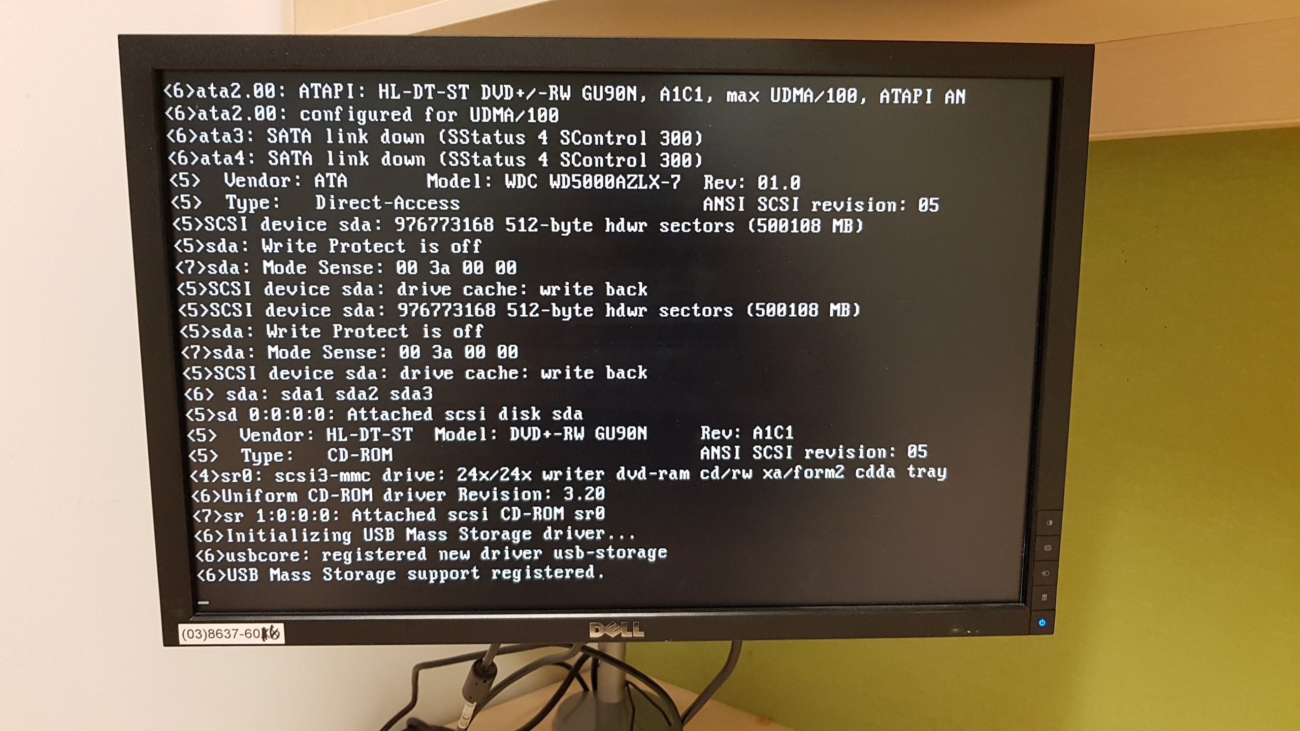

Boot-info from PS2 (ALT-F2) showing kernel booted and devices good. Disk found.
Normal post from tty1 (ALT-F2). DIsk found, usb-storage loaded..

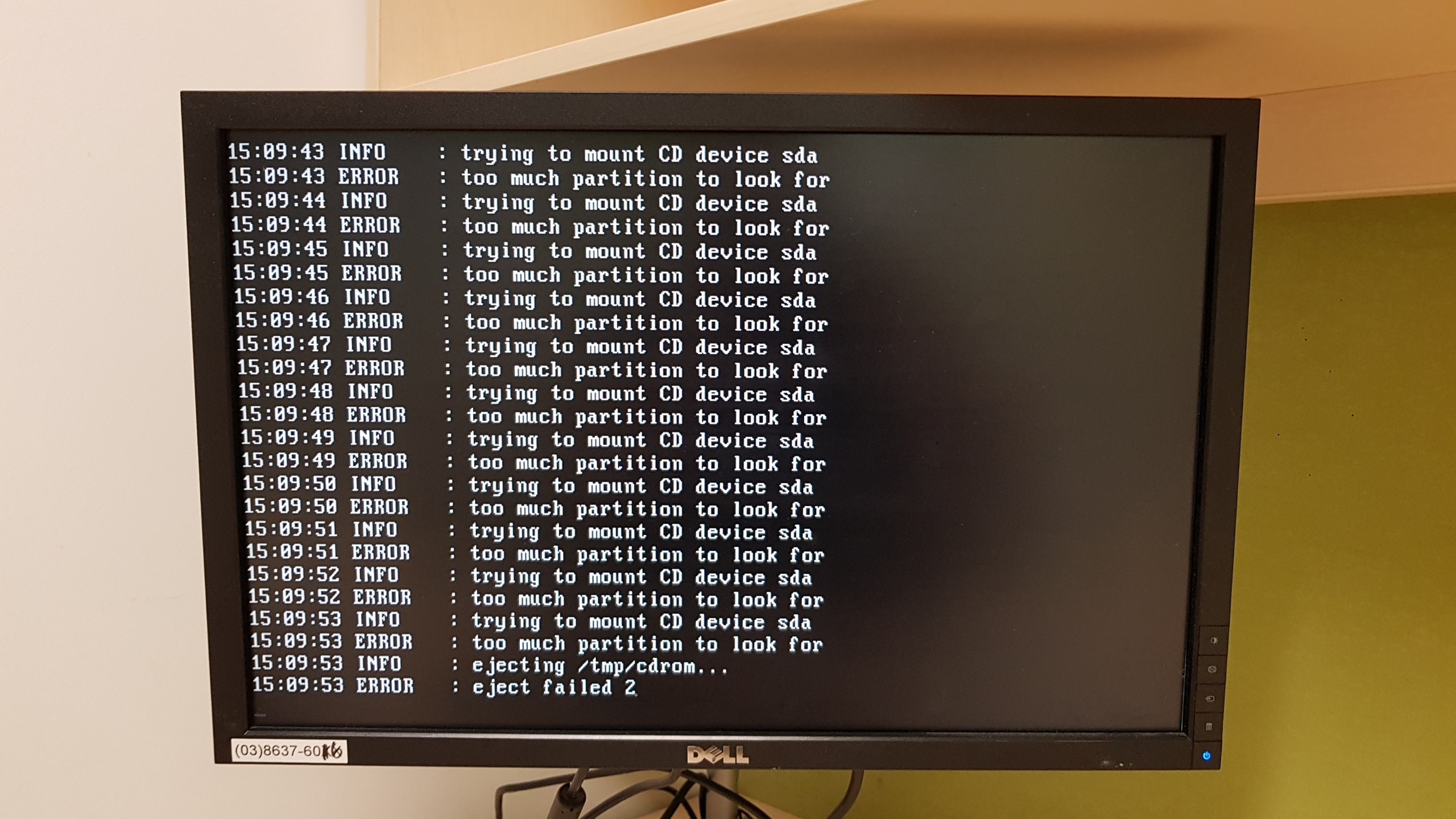

Attempting to mount a CD-ROM for some reason?!
From tty2 (ALT-F3) - for some reason trying to mount a CD device (?).

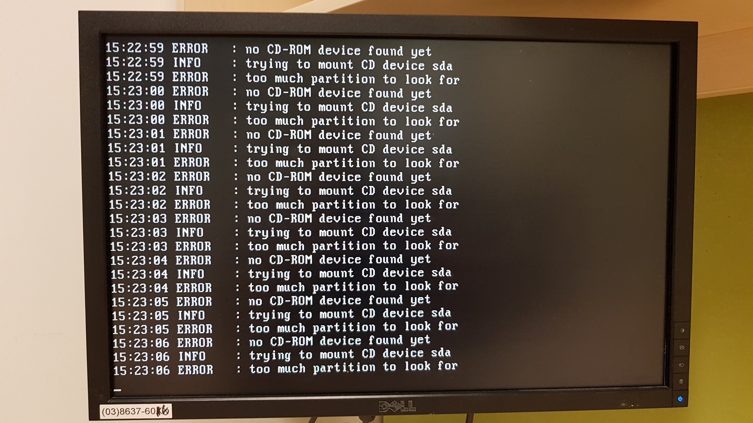

New boot with cd-rom removed from system (disabled in bios)
This is a new boot with the DVD device disabled in the bios. CD device sda?

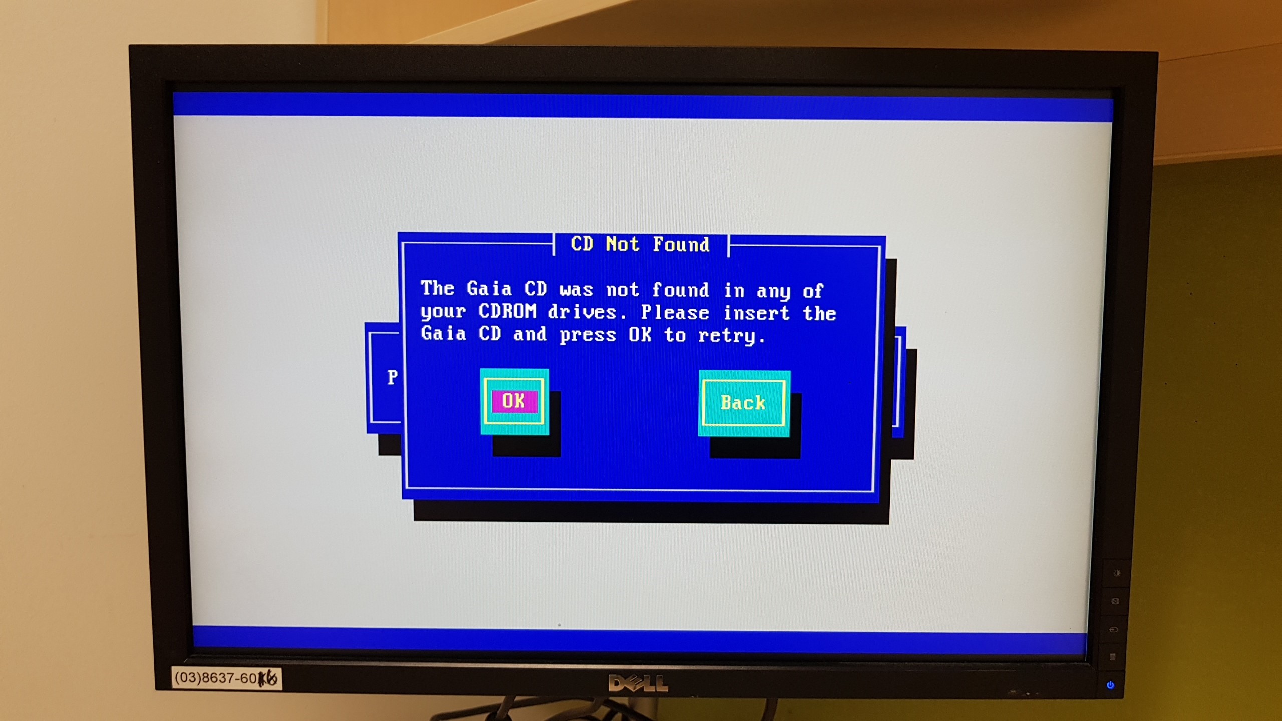

Final error on main console
Here is the final error on main console (tty1 / ALT-F1).
