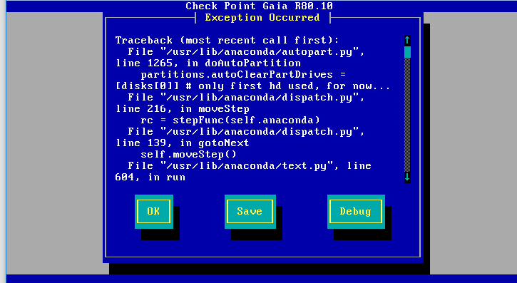

That said, can you scroll down to the bottom of the error message and post a screenshot?
We've seen cases where the light-out-management is recognized as /dev/sda, which can't be formatted.

This Open Server has not been certified yet, maybe one day it will be done, but we still had to use the box and get R80.10 installed. The client has an HP Enterprise agreement (lots of open servers installed) and they purchased 6 of these boxes for this phase of the HW refresh. We had configured another box (3 weeks ago) and installed R77.30 using SK108200 with a max root partition of 2048 GB (max 2T root partition) in built in the HP Array controller. It is presently working hard as a MLM box processing high volumes of logs. Our Diamond Engineer told us of an internal SK that has the exact errors in the attachment - line for line - but it was for R77.30 - we had already made it past that issue with the R77.30 builds.
After spend several hours in the datacenter today, we found the cause of the python error in the doAutoConfigure script - the HP 440 Array Controller 2 TB array setting (configured like the above box) was causing the issue - we wiped out the array, built another one with a 1980 GB root partition, made it bootable, rebooted with no UEFI, and kicked off the install routine - it worked perfectly. After the installation completed, we rebooted several times with no errors. The webui and bond config will occur on 6/12, testing will begin shortly afterwards.

Hi
I'm trying to install R80.10 Security Management server on Vmware vSphere 5.5, which is on the compatibility list, but I get the same kind of error.
I cant find any recommendation for the virtual hardware, so I used the same VM configuration as for my 77.30 security management server.
Network card: E1000
Disk controller: LSI Logic Parallel
This is the error I get:

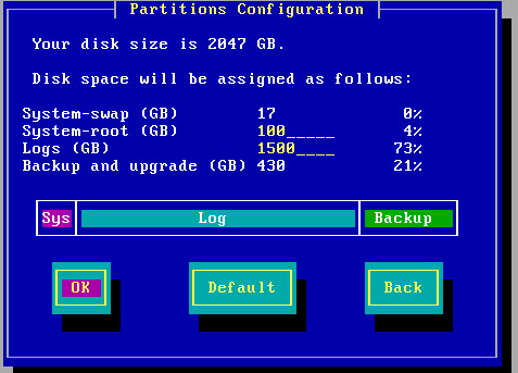

How big of a disk did you allocate in the vSphere settings? Please post a screenshot of the values shown on the Gaia disk partition setup screen prior to this error message occurring.

The same sizes as on my R77.30 server
Try the following:
1) Reduce total disk size to 1980GB and try the load again.
2) If that doesn't work, try removing all nonessential hardware from the VM (especially USB), as Gaia setup may be trying to access/format something it thinks is a disk but isn't.

Hi Tim
I reduced the total size to 1980G, and that worked, thanks
Why???, what's problem, is this a bug or undocumented feature?
2TB is the partition size limit, as noted previously.
However, that's raw capacity.
1980GB is what's left after you add the file system overhead.
It's not a bug, it's a known (documented) product limitation.
It has to do with the overhead added to the root partition pushing it over the @TB limit..
