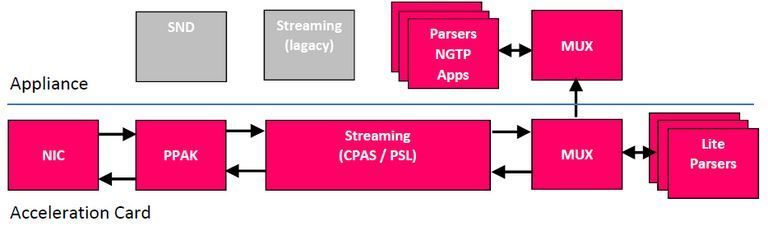

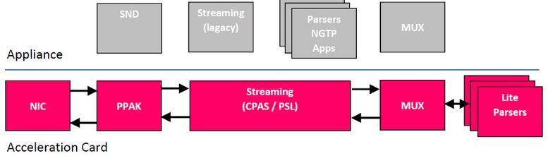

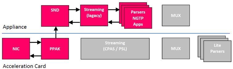

Here are the paths to the Falcon Cards:
R80.20+ acceleration cards provide three new acceleration flows:
Inline path - For HTTP response body (until 1st tier match) and TLS bulk encryption/ decryption.
Buffer path - For HTTP requests, HTTP response headers and TLS handshakes.
Host Path - For non acceleration connections (eg. local connections) and connections on non acceleration card interface.
