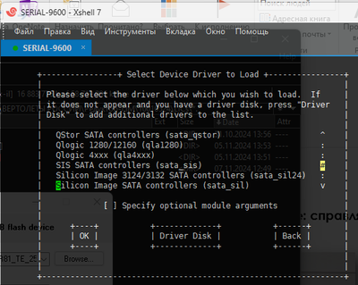

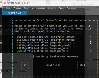

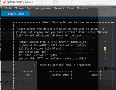

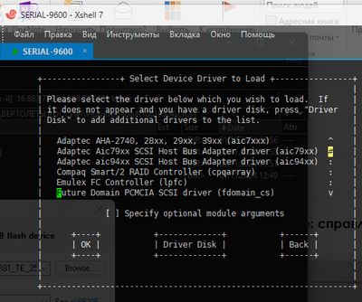

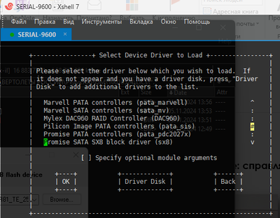

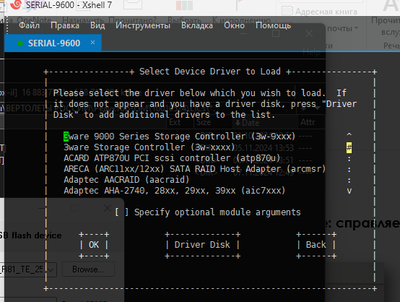

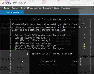

I took a special soft R81 for TE250XN - it doesn't fit, it asks to select a disk for installation:
+-----------------+ No driver found +------------------+
| Unable to find any devices of the type |
| needed for this installation type. |
| Would you like to manually select your |
| driver or use a driver disk? |
| | Select driver | | Use a driver disk | | Back | |
And this selection:
EVSolovyev
Collaborator
Think, may be this helps me. But not (try 5 flash drives). Every time I see:
