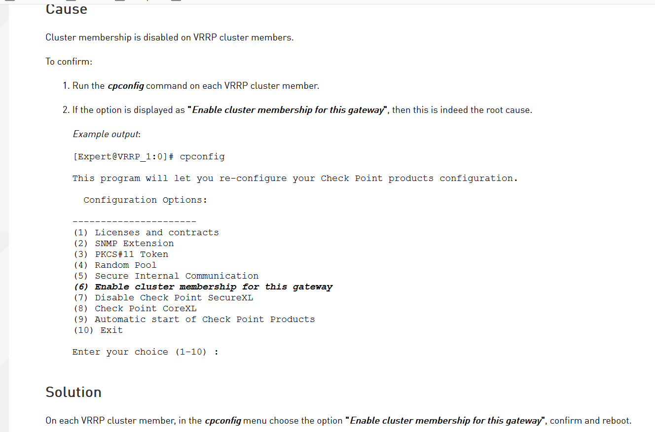

Hi All,
Migration is successful.
Steps are as per below:
1. Disconnection the network cables from Backup VRRP cluster in IPSO-390 appliance.
2. Connect the cables to Backup VRRP cluster at 5600 - Gaia appliance.
3. Reset SIC and fw unloadlocal and SIC is established at backup VRRP cluster.
4.  And, perform above 1-3 steps in Master VRRP cluster at 5600 - Gaia.
5.  And then, Get topology, version at cluster object.
6.  Push down the policies to Cluster object. but Push policies is failed.
7. But, manage to resolve the issue after follow-up as per below kb. And, all of VRRP cluster are up and running and policies are able to push down the cluster object also.
VRRP cluster members are in "Backup/Backup" state
Thank you, everyone in this post!

cpconfig should have been run directly after the FTW and make sure clustering is enabled.
Also make sure that the priority is lower than the current active member and vrrp disable-all-virtual-routers is set to on.
