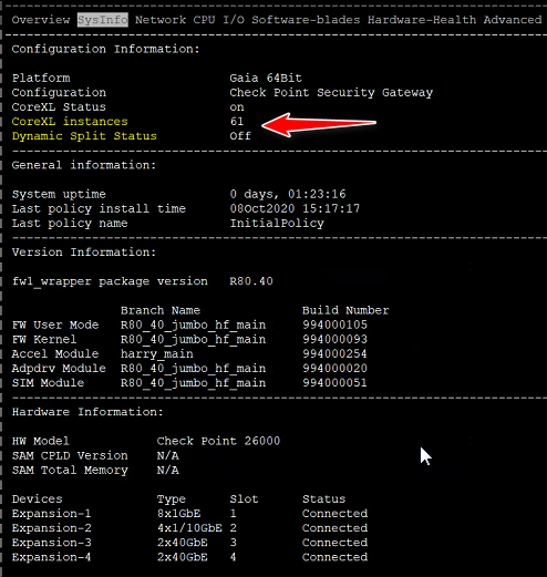

Hi Checkmates,
We are planning to replaced our existing device (12000 SG) with new 26000 Security Gateway.

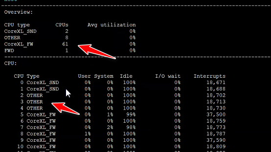

The existing CoreXL configuration of 26000SG is below
Total CORE with SMT enable: 72 Core
CoreXL_SND: 2
OTHER:8
CoreXL_FW: 61
FWD:1
What is the role of "OTHER" which currently occupied 8 CORE  and why its dynamically allocated ?
Our current running appliance 12000 series will going to replaced with 26000 and currently having below configuration :
Total Core: 4
SND Core: 1
CoreXL_FW: 3
BLADE Enabled: IPSec,IPS,AV,ABOT,App and URL(No Https Inspection) (will also enable TE blade after replaced)
Concurrent connection :25000 (In future it will be increase)
Interface: 5 x 1G including sync and Mgmt (It will replace with 3 x10G)
Kindly suggested  as a best practice how much CPU core need to assign to SND core and CoreXL_FW on new 26000.

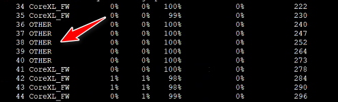

As you can see CPU 2,3,4,36,37,38,39,40 is assign to "OTHERS" which not showing on below output.
Just I need to understand what is the use of "OTHER" CPU core and is this only comes when we enable SMT (Hyper threading) ?

So far it seems they are not attached to neither SND nor CoreXL

Okay, that's very good then. With R80.40 and 3.10 kernel, you have Dynamic Split feature mentioned in sk164155. All you need for an effective core distribution is two fold:
1. do not change manually affinity and corexl settings
2. enable dynamic split, as SK says.
Your cores will be automatically balanced between FWK and SND roles, depending on the traffic needs.

What is the role of "OTHER" which currently occupied 8 CORE by default ?
Regards
@Chinmaya_Naik
_Val_
Can't say, but I assume those were not attached to either SND or FWKs, or were/are in the transition phase from one role to another.
