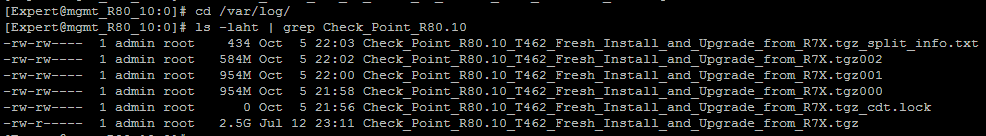

Hi,
just upgrading some clusters from R77.30 to R8.10 using CDT 1.5.2 . Send R80.10 package does not work on some of the nodes.
        Remote Control error has occurred. IP = ***.***.***.***, command =
        Error code 15 - Error sending a file to a remote machine.
        Check SIC connectivity.
        Details:
        File is too large.
Any idea what to do?
At the affected nodes i transfered the file using scp as workaround. Using cdt would be better, indeed Smiley Happy
and now to something completely different - CCVS, CCAS, CCTE, CCCS, CCSM elite
Vincent_Bacher
MVP Silver
MVP Silver
Just found the cause of the issue (thanks to Eliran):
I upgraded from beta to ga release of cdt.
The package was originally in /home/admin/ and I copied it (with the split files and the split_info.txt file) to $CDTDIR (and newly created subdirectory). The content of the split file still contain /home/admin paths.
So had to delete these file and keep only the FCS package.

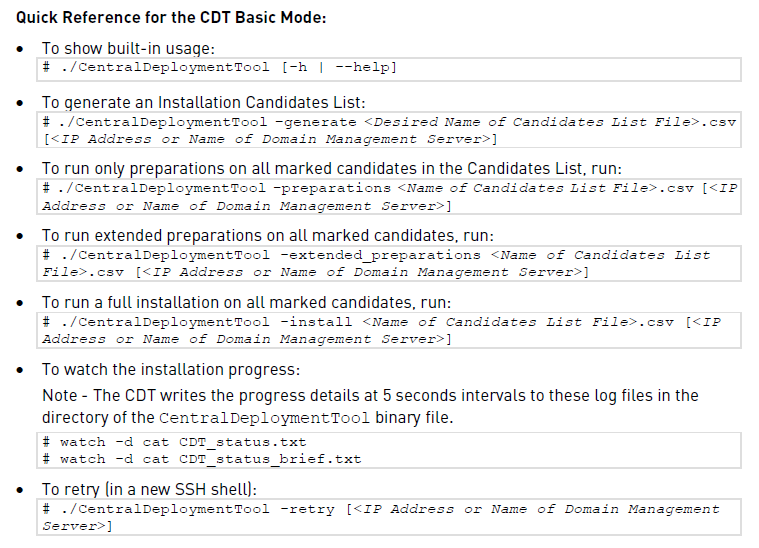

Authority
Authority
Okay, so I am trying to test CDT 1.5.2 from single SMS R80.10 management and I have to say that I am very confused. The instructions are very bad written and admin is totally confused how to simply generate candidate list and so on...
After 30 minutes I figured out that candidate list can be generated via following command:
./CentralDeploymentTool -generate -candidates=list.csv -deploymentplan=DepPlan.xml
All needed options have been modified (commented) in DepPlan.xml and CentralDeploymentTool.xml.
The candidate list has been generated.
Now, I want to move both packages (RPM + TGZ) to the candidate members, install RPM and verify TGZ - means I need to use EXTENDED PREPARATIONS option of BASIC mode.
According to manual, I need to use following syntax:
I have tried following variants:
./CentralDeploymentTool -execute -extended_preparations -candidates=list.csv -deploymentplan=DepPlan.xml
./CentralDeploymentTool -execute -extended_preparations list.csv
./CentralDeploymentTool -extended_preparations list.csv
None of above mentioned commands are working (Invalid argument: -extended_preparations).
Can someone, please, figure out for me what is the correct syntax ?
EDIT:
So, finally I solved it  What I did was .... read whole documentation from page 1 to the last page
What I need is just modify CentralDeploymentTool.xml, NOT DepPlan.xml. I modified both.
After that, the candidate list was generated:
./CentralDeploymentTool -generate test.csv
And at the moment the extended_preparations is in progress:
./CentralDeploymentTool -extended_preparations test.csv
Kind regards,
Jozko Mrkvicka

Hi Jozko,
Sorry to hear about the confusion in our documentation. I will try to make it clearer.
Meanwhile, let me explain:
The CDT Basic Mode command ‘extended_preparations’, as you have figured out, is used to send packages from the management machine to the connected firewalls. The same could also be done in the Advanced Mode, but in a different way – In Advanced Mode, you can construct a Deployment Plan (the xml file which contains a list of actions to perform on each machine) with any combination of actions you want. If you just need to send the packages to the firewalls, you can create a deployment plan with just 1 action (import_package) and then execute it. You can create another deployment plan to do the actual installation.
Most of your commands have not worked because you were trying to use an Advanced Mode command (-execute) with a Basic Mode parameter (-extended_preparations). The 4th command you mentioned (with just the –extended_preparations parameter) should have worked. Do you remember if you used a copy&pasted command? If you did, that could have been the issue. If not – please share the exact output that you get when trying to run ./CentralDeploymentTool -extended_preparations list.csv
Regards,

As I figured out, the content of DepPlan.xml is irrelevant in this case, as I want to go via Basic mode and extended_preparations.
So finally I was able to run CDT with syntax:
and waited around 2 hours to finish the job.

Second issue I see is that on the management server where I run CDT, the following files were created and wasnt removed after CDT finished the job:

You are correct that when using the Basic Mode, there is no deployment plan involved - so the DepPlan.xml file is indeed irrelevant.
Regarding your first issue - CDT takes the CPUSE rpm from the configured path in CentralDeploymentTool.xml (in you case it was /var/log/CPda-00-00.i386.rpm), and installs it on each of the members. Are you sure that you put the rpm for build 1573 in that location? If you did - please share your CDT log files (in /var/log/CPcdt/ , if you executed CDT multiple times then just share the directory with the relevant execution time).
Regarding your 2nd issue - the files you see are parts of the R80.10 upgrade package. CDT splits big files before it sends them, due to infrastructure limitations. It keeps the split package to mark that it doesn't need to be split again. You can delete these files manually if you want.
