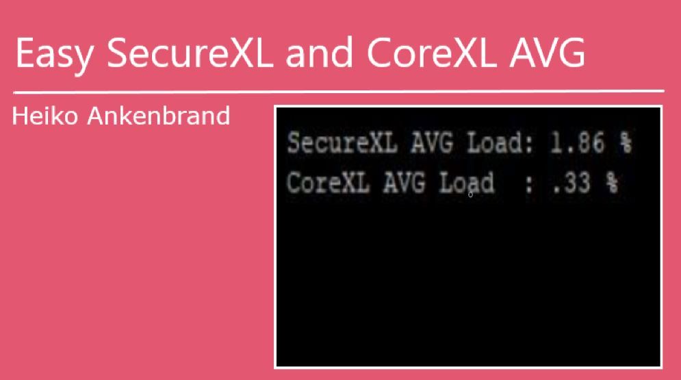

This oneliner (see spoiler) shows you the average CPU time of all CoreXL and SecureXL instances.
SXLHACPU=`fw ctl affinity -l -a -v |grep Interface | awk '{print $6}' | sort |uniq | awk '{LINEHA = LINEHA "|CPU"$1} END {print LINEHA }' | sed s/\|//`;SXLHACPU_C=`sar -P ALL 1 1 | grep Average: |grep -v CPU |grep -v all | awk '{ print "CPU"$2 " " 100-$8}' |egrep $SXLHACPU |wc -l`; SXLHACPU_S=`sar -P ALL 1 1 | grep Average: |grep -v CPU |grep -v all | awk '{ print "CPU"$2 " " 100-$8}' |egrep $SXLHACPU | awk '{sum+=$2} END {print sum}'`; SXLHACPU_LOAD=`echo "scale=2; $SXLHACPU_S/$SXLHACPU_C" |bc `; echo; echo "SecureXL AVG Load: $SXLHACPU_LOAD %"; U=`cpprod_util FwIsUsermode`; if [ $U == "0" ]; then CXL_LOAD=`top -b -n 1 |grep fw_worker | awk '{sum+=$9}END{print sum}'`; else CXL_LOAD=`top -b -n 1 |grep fwk0_dev|awk '{print $9}'`; fi;if [ $CXL_LOAD == "0" ]; then CXL_LOAD="1"; fi ;typeset -i CXL_C; CXL_C=`fw ctl multik stat | wc -l`;CXL_C=$CXL_C-2; CXL_LOAD_INT=`echo "scale=2; $CXL_LOAD/$CXL_C" |bc -l`; echo "CoreXL AVG Load : $CXL_LOAD_INT %";
Output:
Or use this tool for much more information on all your gateways :
Easy View Tool - View System Info for All Gateways Simultaneously
Output:

Thanks Heiko, but there is still a bug 🙂
Here the output (securexl avg always 100%):
I expect mpstat is different:
[Expert@nb-ckp-gw1:0]# mpstat -P ALL
Linux 3.10.0-957.21.3cpx86_64 (nb-ckp-gw1) 04/14/20 _x86_64_ (4 CPU)
14:07:53 CPU %usr %nice %sys %iowait %irq %soft %steal %guest %gnice %idle
14:07:53 all 1.55 0.00 1.60 0.03 0.26 0.20 0.00 0.00 0.00 96.36
14:07:53 0 0.12 0.00 0.05 0.03 0.31 0.55 0.00 0.00 0.00 98.94
14:07:53 1 1.53 0.00 1.95 0.02 0.22 0.09 0.00 0.00 0.00 96.18
14:07:53 2 2.08 0.00 2.02 0.05 0.24 0.08 0.00 0.00 0.00 95.53
14:07:53 3 2.47 0.01 2.36 0.05 0.25 0.09 0.00 0.00 0.00 94.77
With the 3.10 kernel idle is on position 12 and with the 2.6 kernel on position 10.
I will modify the script again soon.
Hi @Norbert_Bohusch ,
Now with "sar" instead of "mpstat".
Should work now.
Can you test it?
Thanks
Heiko
