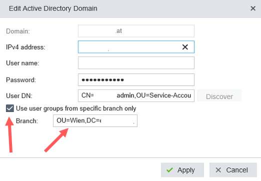

A customer reported that after updating the firmware from R77.20.75 to R77.20.8x on locally managed 730, RA VPN clients could no longer authenticate with AD credentials as the SMB GW did not communicate with the AD anymore. It needed an adjustment for different parsing of OUs in AD - but i could find no documentation or remark about this. Did anyone experience the same issue ?

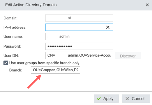

Customer explained that he originally had restricted the AD to a branch containing all windows user groups needing RA VPN access.
Now he had to use a OU branch containing also users from the AD VPN group.
