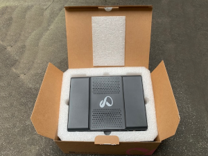

Q: Is there an unboxing video ?
A: Sure, it's right here.

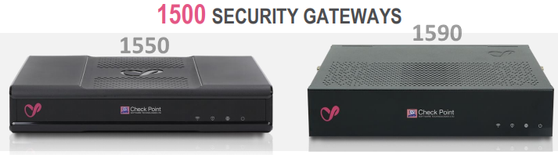

Q: Which 1500 Appliance hardware models are available ?
A: Model: V-80 Check Point 1550 Appliances
A: Model: V-80W Check Point 1550 Appliances (WiFi)
A: Model: V-81 Check Point 1550 Appliances
Q: What is part of the content package ?
A: The appliance itself, a power supply, two network cables, a USB-C serial console cable and the usual Getting Started Guide.
