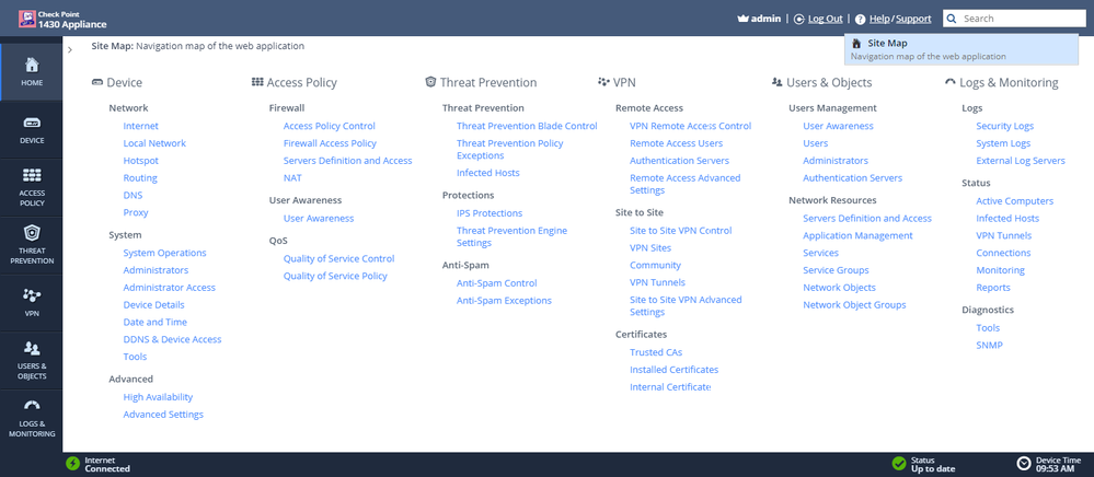

Q: Where can I find the sitemap for quick access to all available configuration pages ?
A: Right under "Home > Site Map".

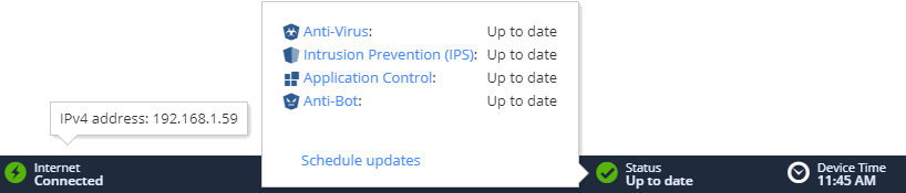

Q: Where can I quickly view my 1400 Appliance's status in the Web UI ?
A: Right at the status bar. Mouse-overs provide you with quick status overviews, clicks forward you to the specific configuration pages.

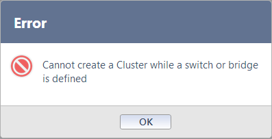

A: The Sync interface is usually configured on LAN2. Using the wireless interface as the Sync interface is not supported.
A: Before configuring a local cluster, make sure that the sync interface is unassigned by checking the Device > Local Network page in the WebUI.

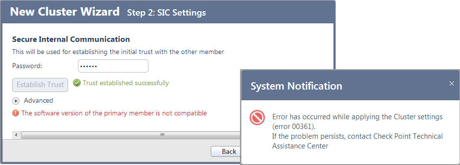

Q: Can I configure a Check Point 1400 Appliance cluster with cluster nodes running on different firmwares ?
A: No. This would lead into the following error:
Q: Is there any other limitation when considering to run Check Point 1400 Appliances in clustering mode ?
A: Yes, you can't neither use switches nor bridges in the local configuration of your 1400 Appliances.

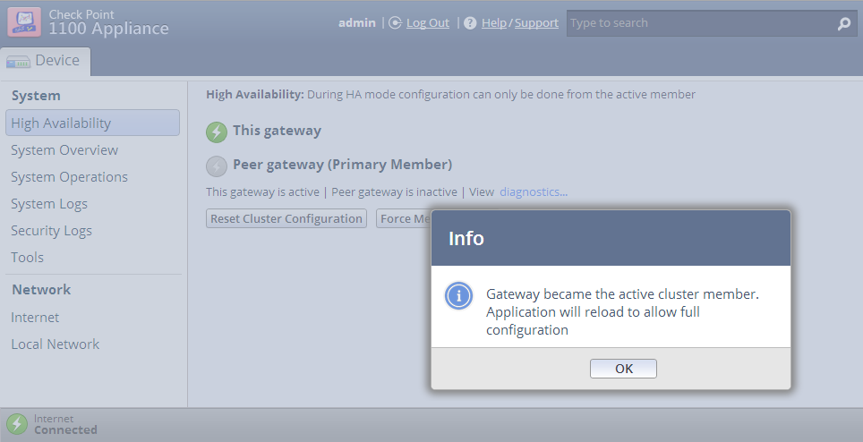

Q: How do I know if my inactive cluster node became active when running Check Point 1400 Appliances in clustering mode ?
A: In centralized management just check SmartView Monitor. In local management you'll receive a notification in the WebUI.

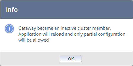

Q: How do I know if my active cluster node became inactive when running Check Point 1400 Appliances in clustering mode ?

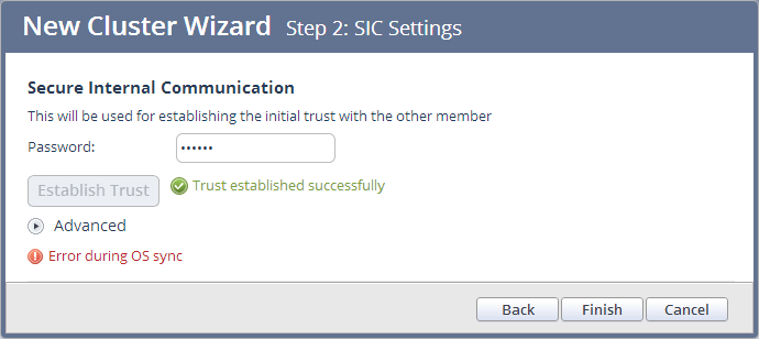

Q: I keep getting an 'Error during OS sync' at the end of my Check Point 1400 Appliance cluster configuration ?
A: To overcome this issue just reboot your Check Point 1400 Appliance without closing the error window shown below.

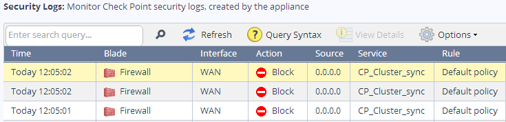

Q: Why is my VoIP phone not working behind my locally managed 1400 Appliance ? Why does my IPS blade still blocks SIP traffic with the error message 'IPS - SIP data malformed or Error with SIP data.' even after I turned it off ?
A: Because on Check Point 1400 Appliances that are locally manged, the implicit policy rules of the IPS blade are working, even if the blade is turned off or an exception rule is created. sk93200 provides a solution by changing the default port (5060) of the SIP_TCP and SIP_UDP objects and creating two new ones. This circumvents the content inspection engine and therefore will allow your VoIP phone to work.
