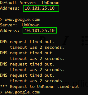

According to the client, dns queries are being send to a correct remote server:

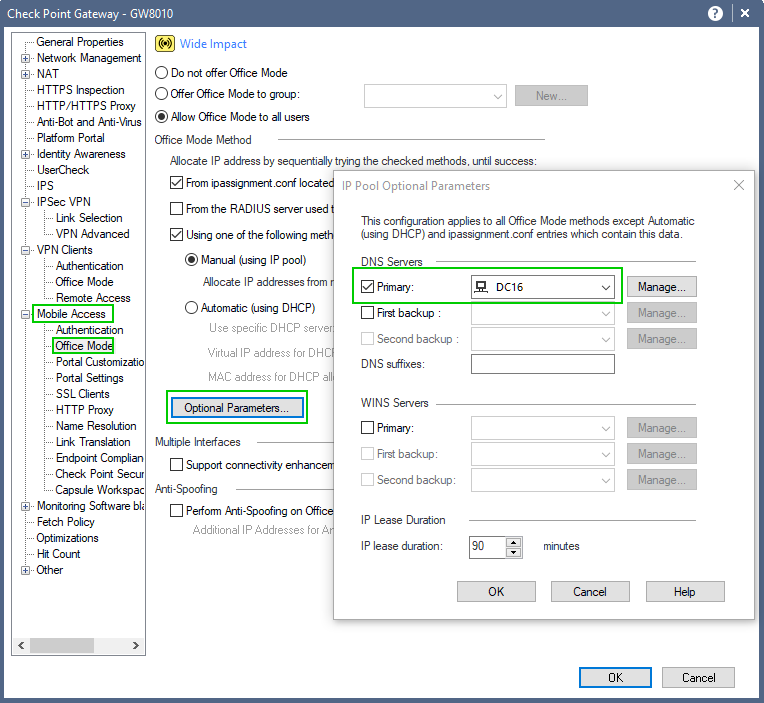

This is the DNS server configured in the Office Mode Optional Parameters:

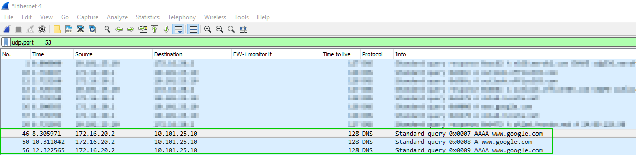

Packet capture on the client seem to suggest that all is well:

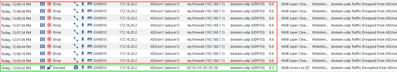

But the firewall, after encrypting session claims that the queries are being addressed to another IP (client's WiFi DNS):
Session:

I am aware of the Windows 10 DNS leakage issues and have addressed those, but this does not look like it, as the queries being actually forwarded to the gateway and not blasted out of Wi-Fi.

Looking at timestamps, there's 12 secs between DNS request to the "right" DNS and the "wrong" one I would guess client didn't receive response to the first request so it started trying any DNS it can find on any other interface, resulting in using WiFi DNS. Probably windows behaviour. Check if first request was forwarded to DNS and response arrived to DNS OK. Hope you understood where I'm trying to get to

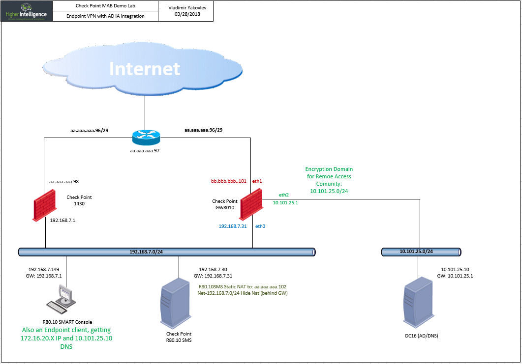

May have something to do with the topology of the lab.
Let me run the wireshark on DC and see what it is seeing in terms of the query origin.
