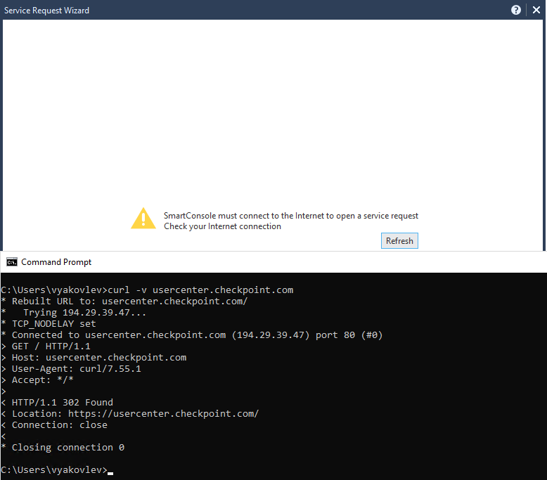

Any Ideas?
Last time it was caused by the outage on CP side.
There is also an issue with auto-upload to SR if the resultant file is larger than 25MB, I think.
In later case, you'll have to do it via SFTP.
Wikipedia says this regarding 302 Found status code:
Expecting https connection, instead of http ?
Needless to say, the SmartConsole does have the ability to connect via HTTPS. The output of curl is there to simply illustrate that the resolution and the Internet access are present.
Even though thecurl show a https url in the text, it does not mean it is using https, you need to tell curl to use: https://usercenter.checkpoint.com

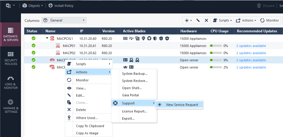

R80.20 MDS:
We've had a few random issues with UserCenter over the last couple days--this could very well be related.
It still is an issue today.
I will be out of circulation for a week, but will have to open an SR o get to the bottom of this when i am back.
It looks really bad when I am trying to showcase the ease of use and streamlined support operations in R80.20 and run into something like this.
I'd appreciate it if you could forward this to a team handling this:

From Cluster Members:
[Expert@MACP01:0]# curl -v -k https://usercenter.checkpoint.com/usercenter/services/ProductCoverageService
bash: curl: command not found
[Expert@MACP01:0]# curl_cli -v -k https://usercenter.checkpoint.com/usercenter/services/ProductCoverageService
* Trying 194.29.39.47...
* Connected to usercenter.checkpoint.com (194.29.39.47) port 443 (#0)
* ALPN, offering http/1.1
* Cipher selection: HIGH:!RC4:!LOW:!EXP:!aNULL:!SSLv2:!MD5:!aECDH:!EDH
* *** Current date is: Thu Nov 22 11:23:59 2018
* TLSv1.2 (OUT), TLS header, Certificate Status (22):

I have the same issue and same test results. (Also on R80.20 management)
Just found this; before I try it - wanted to see if you guys are still seeing this issue. I know we just migrated to a whole new support backend
Thanks Vladimir! Appreciate the quick response. Still a cool feature, as long as we aren't sending up cpcaps. 🙂
I think it could probably be further improved by automating SFTP upload option.
