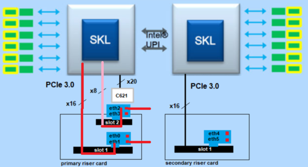

  • Total traffic with one CPU from eth1 (primary riser card slot1) to eth2 (primary riser card slot2).

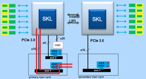

  • Total traffic with one CPU from eth1 (primary riser card slot1) to eth0 (primary riser card slot1).

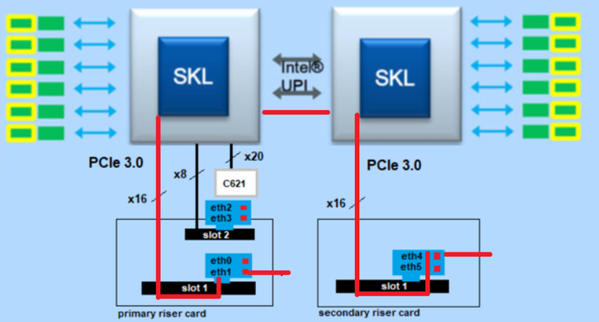

  • The total traffic with two CPU's from eth1 (primary riser card slot1) to eth4 (secondary riser card slot2).
The big question is which architecture is faster?
Is there any experience here?

I had checked this in the lab and this solution was the fastest path:
