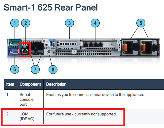

Hello,
Why newest Smart-1 appliances don't have LOM available, despite the fact there is LOM interface on the appliance ?
For example Smart-1 625 appliance:
What does it mean "For future use - currently not supported" ? Can we expect this will be allowed by some newest Take, or new version ?
LOM was available for almost all older Smart-1 appliances (25, 25B, 50, 150, 225, 3050, 3150).
LOM port is available on following Smart-1 appliances, but is not working at all:
Smart-1 525
Smart-1 5050
Smart-1 5150
Smart-1 625
Kind regards,
Jozko Mrkvicka

Check Point is in the process of integrating the LOM (iDRAC) with GAIA in order to provide more secured and robust operations.
As to when this will be formally supported, I can't say for sure.
I would check with your local Check Point office.

Check Point has just removed the LOM checkmark for Smart-1 625 appliances from their Smart-1 Datasheet. I wonder why they didn't remove the checkmark for their other Smart-1 appliances as well as these neither have LOM support (see Known Limitations).
Check Point's newest Smart-1 appliances are DELL Open Servers as mentioned by Check Point. I guess this is why all LOM commands built into the Gaia clish are not working > these are built to run with Check Point LOMs only. iDRAC support is decribed here. On Smart-1 appliances LOM is called iDRAC (integrated DELL Remote Access Controller). Luckily you can still use ipmitool in expert mode to talk to the LOM and check that fans, temperature, voltage and everything is ok. I created a SmartConsole Extension - LOM Info to make LOM checks within SmartConsole really easy. 😊
_Val_
@JozkoMrkvicka & @Danny
AFAIK, there are certain concerns with iDRAC implementation on these servers. Although there are plans to support iDRAC in the future, we are still working on addressing those concerns from our side. LOM support will eventually come, when we are confident that all issues are addressed and do not present security and/or stability risks. However, the process does not only reside in Check Point, other parties are involved.
If you have a strong case of necessity to use LOM for your SMART-1, you can address this with your local Check Point office.

Hi,
I am glad to say that enabling and updating iDRAC FW is now available, more info in sk122914, relevant documentation will be modified as well.
