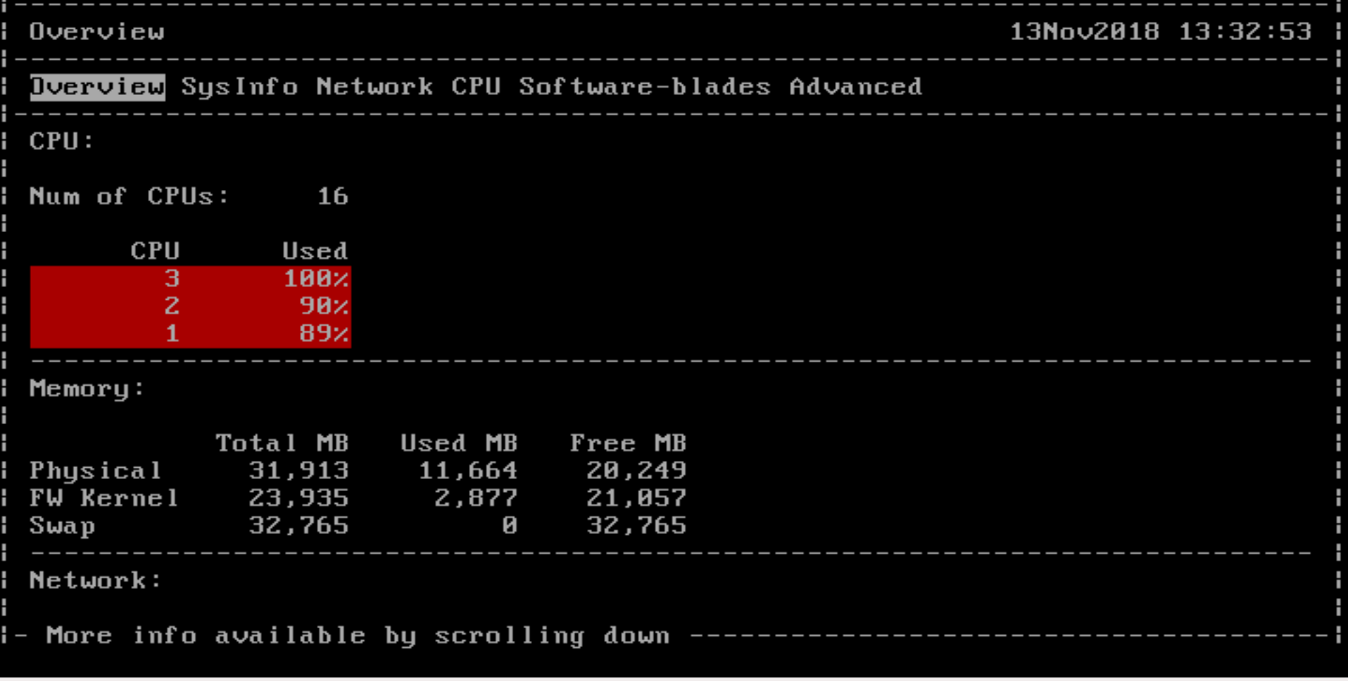

Hello,
we have an Open Server with Check Point R80.10 ClusterXL (two nodes) with these enabled blades: IPSec VPN, Mobile Access, Application Control, URL Filtering, IPS, Anti-Virus, Identity Awareness, Monitoring. The server has 16 CPUs but was licensed for 3.
Sometimes/randomly it happens the active node freezes; the console (SSH) becomes unavailable. Before resetting it forcibly I managed to launch cpview and take this screenshot from iLO (it is an HPE server):
Now I understand it should be necessary a deep investigation; but what's could be the root cause for all CPUs reaching more than 90% of usage ? Do you think 3 processors license are enough for all enabled blades ?
Thank you,
Luca

As Danny mentioned, Super Seven outputs would be helpful here.  Your screenshot shows cores 1-3 which are all your Firewall Workers getting very busy which indicates a lot of PXL or even F2F path traffic.  Some tuning will probably help, but not as much as licensing another 4 cores I would imagine, as the only things cores 4-15 can do is handle generic Gaia/Linux processes.
There is not a "core crunch" present as there is only one Firewall Worker assigned to cores 1-3 each.
