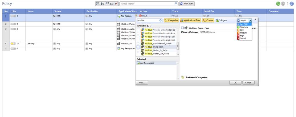

Following we will see how we can create an application based on SCADA protocol command and address which trigger the proper ICS activity , link it with a policy and detect and prevent it based on time configuration
Let consider that we manage an Industrial Control system based on Modbus protocol. The process requires a daily machinery backwash sequence at a specific time of the day. During the rest of the day we want to be advised or even to block any attempt to start the backwash sequence, as it can damage or even cause production to stop.
How we can solve this necessity with Check Point ICS solution:
  1. In the application control blade, we will create an application to monitor the Modbus write function command for a single address in the PLC, which is responsible for the activation of the backwash sequence.
  2. In addition we will create a new policy and link it with application we created. As the sequence activation out of the required time might harm the process, we will rank the policy as high risk.
  3. Now we can modify the policy time configuration to meet our operational requirements, restricting the command execution out of the permitted hours. The application control blade allows us to configure the time on daily based, days of the week and days of the month. This provide us wider flexibility while required to configure policy time restrictions. Any attempt to start the backwash out of the required time, would be blocked and will not arrive to the destination PLC address.
