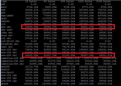

I'd turn on AES-NI in BIOS on Open Server. AES-NI is Intel's dedicated instruction set, which significantly improves the speed of Encrypt-Decrypt actions and allows one to increase AES throughput. Check Point supports AES-NI on many appliances, only when running Gaia OS with 64-bit kernel. On these appliances AES-NI is enabled by default. AES-NI is also supported on Open Servers.
AES-NI is Intel's dedicated instruction set, which significantly improves the speed of Encrypt-Decrypt actions and allows one to increase AES throughput for:
  •       Site-to-Site VPN
  •       Remote Access VPN
  •       Mobile Access
  •       HTTPS Interception
With the following command you can test and compare all encryption methods. After these results I would always recommend to activate AES-NI and AES is preferred to 3DES because it offers many performance advantages through the hardware acceleration.
Warning notice: If you execute this command you have 100% CPU usage for a long time!
# cpopenssl speed
This makes it possible to compare encryption algorithms. It shows that e.g. AES 256 is more performant than DES. Therefore AES 256 should rather be used for VPN connections than DES or 3DES. This is also well described in the following SK Relative speeds of algorithms for IPsec and SSL.

Hi @tniop_kcehc
(nice community name:-)
Tip!
  •       Site-to-Site VPN
  •       Remote Access VPN
  •       Mobile Access
# cpopenssl speed
I had published an article about this that might help you:
R80.x - Performance Tuning Tip - AES-NI

Hi @HeikoAnkenbrand
I'm going to test this command "cpopenssl speed"  in a maintenance window on our current firewall.
Thank you.
