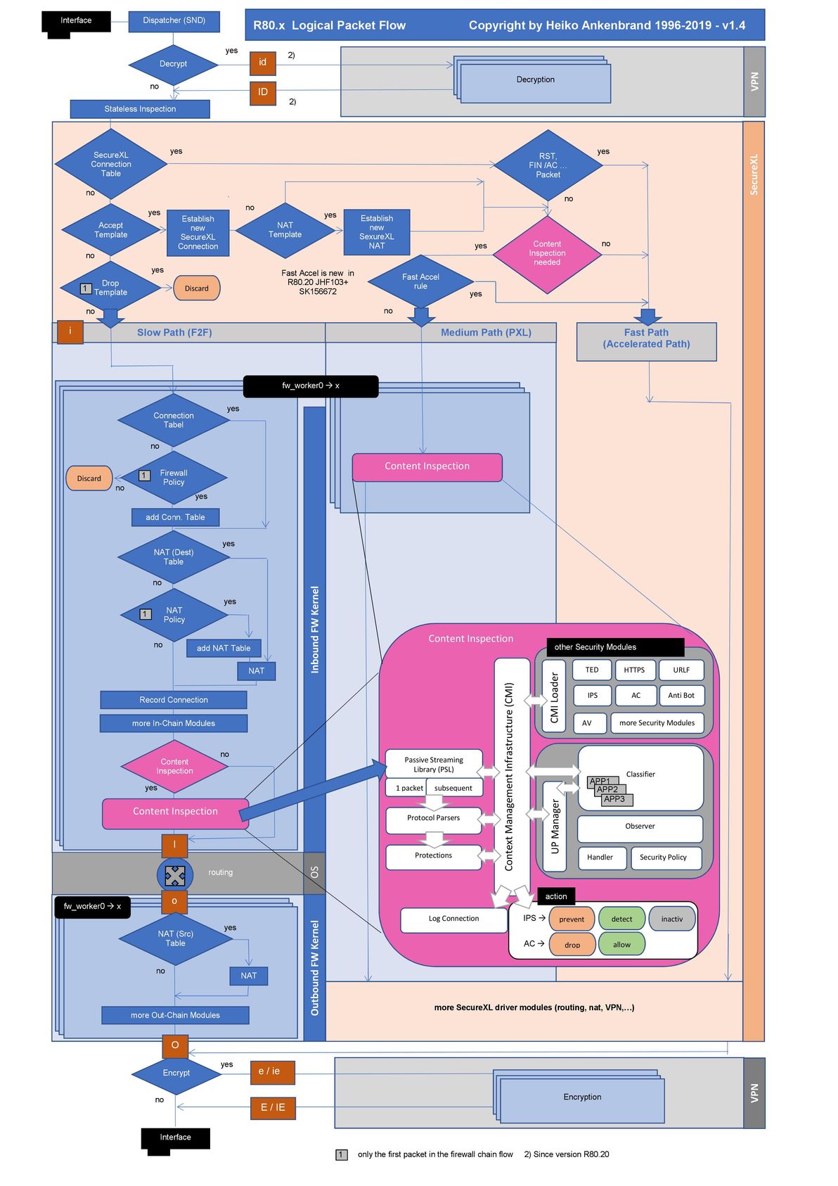

| Logical Packet Flow R80.20+ |
SecureXL has been significantly revised in R80.20. This has also led to some changes in "fw monitor". There are new fw monitor chain (SecureXL) objects that do not run in the virtual machine. Now SecureXL works in part in user space. The SecureXL driver takes a certain amount of kernel memory per core and that was adding up to more kernel memory than Intel/Linux was allowing. The packet flow in R80.20+ is a little bit different from the flow lower than R80.20. Now it is possible to use async SecureXL and other new functions. This figure shows the new features with the reinjection of SecureXL packages. SecureXL supportes now also Async SecureXL with Falcon cards. That's new in acceleration high level architecture (SecureXL on Acceleration Card): Streaming over SecureXL, Lite Parsers, Scalable SecureXL, Acceleration stickiness.
F2V - Describes "Forward to Virtual Machine" path. F2V stands for "Forward to Virtual Machine" from version R80.20 and above. These packets always belong to an existing connection, which are optimized via the SecureXL path. If a packet needs a new Rulbase look up in the SXL path, it is sent to the F2V path. When the rule base lookup is done, the packet is reinjected into the SXL path (accelerated path).
As a result, packets are reinjected with the new SecureXL ID into the correct SecureXL instance again after they have been allowed by access template or rule set. After the packet has been reinjected, the SecureXL ID is added to the SecureXL connetion table and the packet is forwarded to the correct SecureXL instance. Therefore the flow is slightly different to older version before R80.20. This new mechanism also offers the possibility to transfer packets into a new SecureXL instance on Falcon cards.

| Firewall Core |
Inbound Stateless Check:
The firewall does preliminary “stateless” checks that do not require context in order to decide whether to accept a packet or not. For instance we check that the packet is a valid packet and if the header is compliant with RFC standards.
Anti-Spoofing:
Anti-Spoofing verifies that the source IP of each packet matches the interface, on which it was encountered. On internal interfaces we only allow packets whose source IP is within the user-defined network topology. On the external interface we allow all source IPs except for ones that belong to internal networks.
Connection Setup:
A core component of the Check Point R80.x Threat Prevention gateway is the stateful inspection firewall. A stateful firewall tracks the state of network connections in memory to identify other packets belonging to the same connection and to dynamically open connections that belong to the same session. Allowing FTP data connections using the information in the control connection is one such example. Using Check Point INSPECT code the firewall is able to dynamically recognize that the FTP control connection is opening a separate data connection to transfer data. When the client requests that the server generate the back-connection (an FTP PORT command), INSPECT code extracts the port number from the request. Both client and server IP addresses and both port numbers are recorded in an FTP-data pending request list. When the FTP data connection is attempted, the firewall examines the list and verifies that the attempt is in response to a valid request. The list of connections is maintained dynamically, so that only the required FTP ports are opened.

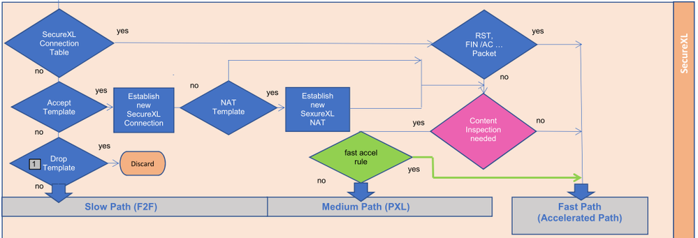

SecureXL path:
Fast path (Accelerated Path) - Packet flow when the packet is completely handled by the SecureXL device. It is processed and forwarded to the network.
Note: In many discusions and images, the SXL path is marked with the "accelerated path". This also happened to me by mistake in this flowchart.
Medium path (PXL) - The CoreXL layer passes the packet to one of the CoreXL FW instances to perform the processing (even when CoreXL is disabled, the CoreXL infrastructure is used by SecureXL device to send the packet to the single FW instance that still functions). When Medium Path is available, TCP handshake is fully accelerated with SecureXL. Rulebase match is achieved for the first packet through an existing connection acceleration template. SYN-ACK and ACK packets are also fully accelerated. However, once data starts flowing, to stream it for Content Inspection, the packets will be now handled by a FWK instance. Any packets containing data will be sent to FWK for data extraction to build the data stream. RST, FIN and FIN-ACK packets once again are only handled by SecureXL as they do not contain any data that needs to be streamed. This path is available only when CoreXL is enabled.
Packet flow when the packet is handled by the SecureXL device, except for:
PXL vs. PSLXL - Technology name for combination of SecureXL and PSL. PXL was renamed to PSLXL in R80.20. This is from my point of view the politically correct better term.
Medium path (CPASXL) - Now also CPAS use the SecureXL path in R80.20. CPAS works through the F2F path in R80.10 and R77.30. Now CPASXL is offered in SecureXL path in R80.20. This should lead to a higher performance. Check Point Active Streaming active streaming allow the changing of data and play the role of “man in the middle”. Several protocols uses CPAS, for example: Client Authentication, VoIP (SIP, Skinny/SCCP, H.323, etc.), Data Leak Prevention (DLP) blade, Security Servers processes, etc. I think it's not to be underestimated in tuning.
Slow path or Firewall path (F2F) - Packet flow when the SecureXL device is unable to process the packet. The packet is passed on to the CoreXL layer and then to one of the Core FW instances for full processing. This path also processes all packets when SecureXL is disabled.

Fast Accelerator - The Fast Acceleration feature (green) lets you define trusted connections to allow bypassing deep packet inspection on R80.20 JHF103 and above gateways. This feature significantly improves throughput for these trusted high volume connections and reduces CPU consumption.
The CLI of the gateway can be used to create rules that allow you to bypass the SecureXL PSLXL path to route all connections through the fast path.

| CoreXL |
CoreXL is a performance-enhancing technology for Security Gateways on multi-CPU-core processing platforms. CoreXL enhances Security Gateway performance by enabling the processing CPU cores to concurrently perform multiple tasks. CoreXL provides almost linear scalability of performance, according to the number of processing CPU cores on a single machine. The increase in performance is achieved without requiring any changes to management or to network topology.
On a Security Gateway with CoreXL enabled, the Firewall kernel is replicated multiple times. Each replicated copy, or FW instance, runs on one processing CPU core. These FW instances handle traffic concurrently, and each FW instance is a complete and independent FW inspection kernel. When CoreXL is enabled, all the FW kernel instances in the Security Gateway process traffic through the same interfaces and apply the same security policy.
R80.20 CoreXL does not support these Check Point features: Overlapping NAT, VPN Traditional Mode, 6in4 traffic - this traffic is always processed by the global CoreXL FW instance #0 (fw_worker_0) and more (see CoreXL Known Limitations).
Secure Network Distributor (SND) - Traffic entering network interface cards (NICs) is directed to a processing CPU core running the SND, which is responsible for:
SND does not really touch any packet. The decision to stick to a particular FWK core is done at the first packet of connection on a very high level before anything else. Depending on SXL settings and in most of the cases, SXL can be offloading decryption calculations. However, in some other cases, such as with Route-Based VPN, it is done by FWK.
Firewall Instance (fw_worker) - On a Security Gateway with CoreXL enabled, the Firewall kernel is replicated multiple times. Each replicated copy, or Firewall Instance, runs on one CPU processing core. These FW instances handle traffic concurrently, and each FW instance is a complete and independent Firewall inspection kernel. When CoreXL is enabled, all the Firewall kernel instances on the Security Gateway process traffic through the same interfaces and apply the same security policy.
Dynamic Dispatcher - Rather than statically assigning new connections to a CoreXL FW instance based on packet's IP addresses and IP protocol (static hash function), the new dynamic assignment mechanism is based on the utilization of CPU cores, on which the CoreXL FW instances are running. The dynamic decision is made for first packets of connections, by assigning each of the CoreXL FW instances a rank, and selecting the CoreXL FW instance with the lowest rank. The rank
for each CoreXL FW instance is calculated according to its CPU utilization. The higher the CPU utilization, the higher the CoreXL FW instance's rank is, hence this CoreXL FW instance is less likely to be selected by the CoreXL SND. The CoreXL Dynamic Dispatcher allows for better load distribution and helps mitigate connectivity issues during traffic "peaks", as connections opened at a high rate that would have been assigned to the same CoreXL FW instance by a static decision, will now be distributed to several CoreXL FW instances.
Multi Queue - Network interfaces on a security gateway typically receive traffic at different throughputs; some are busier than others. At a low level, when a packet is received from the NIC, then a CPU core must be “interrupted” to the exclusion of all other processes, in order to receive the packet for processing. To avoid bottlenecks we allow multiple buffers, and therefore CPU cores, to be affined to an interface. Each affined buffer can “interrupt” its own CPU core allowing high volumes of inbound packets to be shared across multiple dispatchers.
When most of the traffic is accelerated by the SecureXL, the CPU load from the CoreXLSND instances can be very high, while the CPU load from the CoreXL FW instances can be very low. This is an inefficient utilization of CPU capacity. By default, the number of CPU cores allocated to CoreXL SND instances is limited by the number of network interfaces that handle the traffic. Because each interface has one traffic queue, only one CPU core can handle each traffic queue at a time. This means that each CoreXL SND instance can use only one CPU core at a time for each network interface. Check Point Multi-Queue lets you configure more than one traffic queue for each network interface. For each interface, you can use more than one CPU core (that runs CoreXL SND) for traffic acceleration. This balances the load efficiently between the CPU cores that run the CoreXL SND instances and the CPU cores that run CoreXL FW instances.
Priority Queues - In some situations a security gateway can be overwhelmed; in circumstances where traffic levels exceed the capabilities of the hardware, either legitimate traffic or from a DOS attack, it is vital that we can maintain management communications and continue to interact with dynamic routing neighbors. The Priority Queues functionality prioritizes control connections over data connections based on priority.
Affinity - Association of a particular network interface / FW kernel instance / daemon with a CPU core (either 'Automatic' (default), or 'Manual'). The default CoreXL interface affinity setting for all interfaces is 'Automatic' when SecureXL is installed and enabled. If SecureXL is enabled - the default affinities of all interfaces are 'Automatic' - the affinity for each interface is automatically reset every 60 seconds, and balanced between available CPU cores based on the current load. If SecureXL is disabled - the default affinities of all interfaces are with available CPU cores - those CPU cores that are not running a CoreXL FW instance or not defined as the affinity for a daemon.

| FW Monitor Inspection Points |
There are new fw monitor inspection points (red) when a packet passes through a R80.20+ Security Gateway:
| Inspection point | Name of fw monitor inspection point | Relation to firewall VM | Available since version |
| i | Pre-Inbound | Before the inbound FireWall VM (for example, eth1:i) |

In Firewall kernel (now also SecureXL), each kernel is associated with a key witch specifies the type of traffic applicable to the chain modul.
# fw ctl chain
| Key | Function |
| ffffffff | all packets |
| 00000001 | stateful mode |
| 00000002 | wire mode |
| 00000003 | all packets |
| 00000000 | SecureXL offloading |

Accelerated path - Packet flow when the packet is completely handled by the SecureXL device. It is processed and forwarded to the network.
Medium path (PXL) - Packet flow when the packet is handled by the SecureXL device, except for IPS (some protections) / VPN (in some configurations) / Application Control / Content Awareness / Anti-Virus / Anti-Bot / HTTPS Inspection / Proxy mode / Mobile Access / VoIP / Web Portals. The CoreXL layer passes the packet to one of the CoreXL FW instances to perform the processing (even when CoreXL is disabled, the CoreXL infrastructure is used by SecureXL device to send the packet to the single FW instance that still functions).
Firewall path / Slow path (F2F) - Packet flow when the SecureXL device is unable to process the packet (refer to sk32578 - SecureXL Mechanism). The packet is passed on to the CoreXL layer and then to one of the Core FW instances for full processing. This path also processes all packets when SecureXL is disabled.

Q: Why this diagram with SecureXL and CoreXL?
A: I dared to map both worlds of CoreXL and SecureXL in a diangram. This is only possible to a limited extent, as these are different technologies. It's really an impossible mission. Why!
- CoreXL is a mechanism to assign, balance and manage CPU cores. CoreXL SND makes a decision to "stick" particular connection going through to a specific FWK instance.
- SecureXL certain connections could avoid FW path partially (packet acceleration) or completely (acceleration with templates)
Q: Why both technologies in one flowchart?
A: There are both technologies that play hand in hand. The two illustrations become problematic, e.g. in the Medium Path.
Q: Why in the Medium Path?
A: Here, the packet-oriented part (SecureXL) cannot be mapped with the connection-based part (CoreXL). Therefore, the following note from an new Check Point article from Valeri Loukine (Security Gateway Packet Flow and Acceleration - with Diagrams - 08-07-2018) and original article from Moti Sagey (Check Point Threat Prevention Packet Flow and Architecture - 04-25-2017) :

Q: Why is there the designation "Logical Packet Flow"?
A: Since the logical flow in the overview differs from the real flow. For example, the medium path is only a single-logical representation of the real path. This was necessary to map all three paths (F2F, SXL, PXL) in one image. That is why the name "Logical Packet Flow".

You write for R80.40:
>>> CoreXL and Multi-Queue: Improved out of the box experience - Security Gateway automatically changes the number of
>>> CoreXL SNDs and Firewall instances and the Multi-Queue configuration based on the current traffic load.
Will this already be available in a Jumbo HFA with R80.20 or R80.30?
Hi Heiko,
Are there also inspection points for decryption (e and E)?
Are they missing in the drawing?
Thank you for the ecellent drawing.
Regads,
Hong
Great work!
Hi Hong,
it is correct. Inspection points are only in the encryption path.
Regards,
Heiko
Nice flowchart it is very helpful.
THX
excellent work Heiko, amazing detail! very well done ![]()

I have redesigned the SecureXL packet flow in version 1.0h. The first packet that passed through the firewall chain and only then is executed, I have marked it with a "1". I hope this makes the overview even better.

Hi Heiko,
can you also provide a flowchart from content inspection.
Best regards.
Jan
Hi Jan,
it is very difficult to include all packet flows in one diagram. I will try to work on content inspection part in the next days or weeks.
The first thing that was important for me:
- new inspection points in R80 (e and E)
- new MultiCore VPN with dispatcher
In the second step the old known points:
- basic SecureXL flows (access tamplates, drop temp., SXL vs. PXL and F2F,...)
- basic CoreXL flows (dispatcher SND and FW Worker,...)
In the last step the basic overview of CMI with:
- PSL, protocol parser, ...
- new UP Manager in R80
- CMI Loader for other Security Modules (URLF, AV,...)
And it's an attempt to logically map all flows.
In the article's references, you can find some good articles from Check Point on this topic.
Regards,
Heiko

Hi Heiko,
One small clarification. There is a terminological issue, and I blame Check Point for that, but still this is something tht needs to be pointed out.
You mention "new inspection points" "e" and "E" and even put them on the chart. In fact, those are fw monitor inspection points, nothing to do with actual traffic inspection and policy inspection.
We are talking here about additional predefined traffic capture points, as with iIoO. Those are just two more predefined, before vpn encrypt on outbound and after vpn decrypt on inbound. The better term for those would be traffic capture, not inspection points. But since Check Point calls them that, I suggest using the full term to clarify what it is about: fw monitor inspection points.
Thank you for this information.
I adapted the information with "fw monitor inspection points" in the documents.
