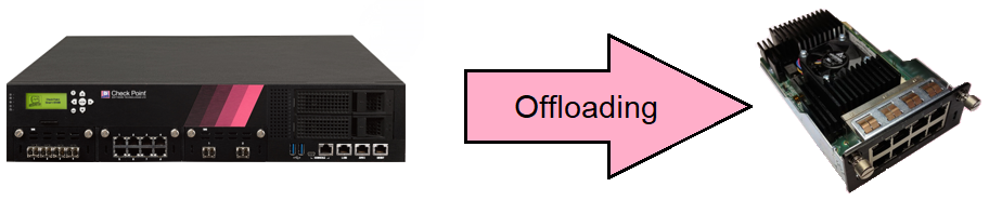

R80.20 SecureXL adds support for Falcon cards to offloading from appliance to acceleration card leaving the appliance to do more.

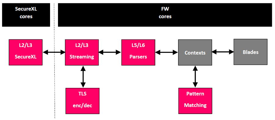

Following features are offloaded to the acceleration card:
  •       SecureXL
  •       Streaming
  •       TLS encryption und decryption
  •       Parsers
  •       Pattern Matching
Following features are working on the host (appliance):
  •        Contexts
  •        Blades (incl. user space)
  •        Rule base
  •        Headers
  •        And more complex logic
    The following flowchart shows the new offloaded features of falcon architecture in pink.
Streaming – serves an important function in the NGTP software architecture. The streaming process creates an ordered packet stream and directly performs a number of security functions on the stream. NGTP can assemble packets into a stream in two ways, passive or active, depending on the nature of the traffic. Each has advantages and disadvantages. The passive mode (PSL) gives little opportunity for modifying the traffic stream. In contrast, the active mode can modify the connection. Active mode essentially proxies the TCP connection and is necessary when performing HTTPS inspection. Active streaming (CPAS) also facilitates timing and buffering when inspecting content such as large files. Keeping the goals of integrated, high security effectiveness and performance in mind, Check Point chose to provide the option to do passive and active streaming, which provides the best balance of security and optimized performance based on actual usage conditions.
Pattern Matcher - Security modules each have a distinct function and they register with the CMI to receive particular context types.
Parsers - Protocols include HTTP, SMTP, DNS, IMAP, Citrix, and many others. Protocol parser instances register with the streaming engine in order to receive ordered streams of data, both client-to-server (C2S) as well as server-to-client (S2C) streams.
TLS encoder/decoder - encrypt  and decrypt TLS sessions.

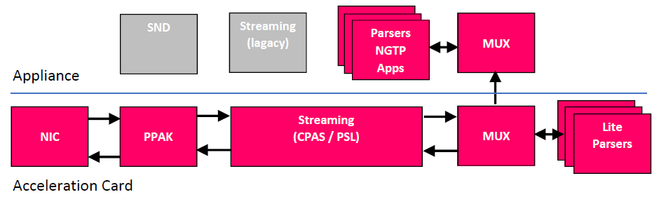

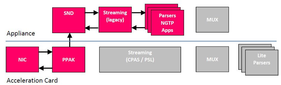

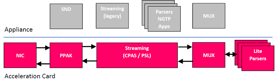

Acceleration Card Path
R80.20 acceleration cards provide three new acceleration flows:
  •         Host path
  •         Buffer path
  •         Inline path
Host Path - For non acceleration connections (eg. local connections) and connections on non acceleration card interface.
Buffer path - For HTTP requests, HTTP response headers and TLS handshakes.
Inline path - For HTTP response body (until 1st tier match) and TLS bulk encryption/ decryption.
