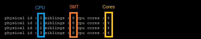

If SMT is activated this command shows the nummbers of CPUs, cores and SMTs:
# grep -E "cpu cores|siblings|physical id" /proc/cpuinfo | xargs -n 11 echo |sort |uniq
