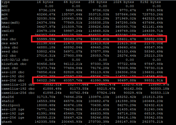

| AES-NI performance measurement |
A little bit of reverse engineering.
Check Point uses OpenSSL as library. Therefore the command "openssl" is provided as "cpopenssl". This gives us the possibility to execute all openssl commands. With this I tested a little bit and came to the conclusion that performance measurements are possible with the following command. So you can test the performance differences with enabled and disabled AES-NI.
Warning notice: If you execute this command you have 100% CPU usage on the firewall for 20 sec.
# cpopenssl speed aes-256-cbc
Enabled AES-NI:
Disabled AES-NI:
After these results I would always recommend to activate AES-NI and AES is preferred to 3DES because it offers many performance advantages through the hardware acceleration.
With the following command you can test and compare all encryption methods. After these results I would always recommend to activate AES-NI and AES is preferred to 3DES because it offers many performance advantages through the hardware acceleration.
Warning notice: If you execute this command you have 100% CPU usage for a long time!
# cpopenssl speed
This makes it possible to compare encryption algorithms. It shows that e.g. AES 256 is more performant than DES. Therefore AES 256 should rather be used for VPN connections than DES or 3DES. This is also well described in the following SK Relative speeds of algorithms for IPsec and SSL.

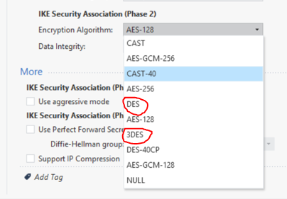

Hi,
I am really shocked and worried that you are still talking and comparing Speed with DES and 3DES. No matter what Speed DES and 3DES has it is insecure and should never be used anymore - independent if it is faster or not. My opinion!
You can check OpenSSH version and you will be surprised ... 😉
Hi Alexander,
The statement I find great.
Point 1:
I totally agree with you. DES, 3DES, SHA1, RC4,… should not be used anymore. That is also a clear recommendation in all my concepts. Now reality is catching up with us. Many firewall environments still use 3DES because the administrators have work with the change to AES-256. I think about 40% of the firewalls I see are still using 3DES. Secure Client connection is also used 3DES as default for phase 2 (see picture) in R80.20. I think it's a security issue.
Point 2:
Performance and security is a difficult issue in firewall tuning. There is a fine line between more security and high performance. This article is about performance and in this case the more powerful AES-256 encryption is also the safer one. It couldn't be better:-)
Point 3:
Please have a look at what Check Point offers with IPSec VPN in phase 1 and phase 2 in R80.20. Here DES and 3DES are still provided.
From my point of view, DES and 3DES will continue to exist for a long time. Why? Many other manufacturers do not manage to implement high encryption standards. These are often seen in medical sector or in industry sector. It's even worse for industrial systems. Often no encryption is used here
And I agree with you, away with DES, 3DES, SHA1, RC4.
Regards
Heiko
