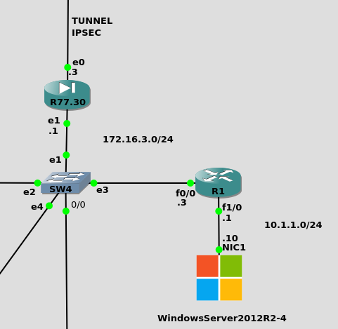

The question is that when I connect one router (R1) to the gateway(R77.30) and put one PC(WS2012R2-4) behind the router the tunnel not worked as expected.
Behind the router I have the network 10.1.1.0/24 and I do some NAT manipulation on the gateway, like that:
I want to manipulate the traffic coming from the PC 10.1.1.10 to appear in the tunnel on the other side with the Source 172.16.3.20.

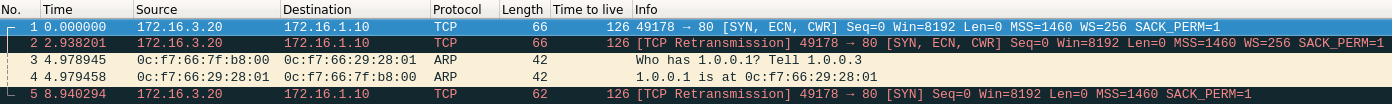

I captured traffic with the wireshark from the outside interface eth0 (See the topology above), and I forced traffic through the tunnel with the PC 10.1.1.10, but nothing happened, please see below the packets:
Source NAT works fine, but I cannot setup the tunnel, why this happen?

as I understand your traffic capture is from eth0 and this is the external interface of your firewall.
If you did the capture with tcpdump you should never see the NATed packet on eth0, the packet should be decrypt.
You should add net 10.1.1.0/24 or the one host 10.1.1.10 to your local encryption domain on the CheckPoint gateway.
And in the rulebase you too need to allow this net to pass th VPN.

Hello Luis,
Wolfgang

I see that you have ARP traffic from 10. network on your external Check Point interface's packet capture.
If you are building this environment in GNS, beware:) some weirdness is expected.
