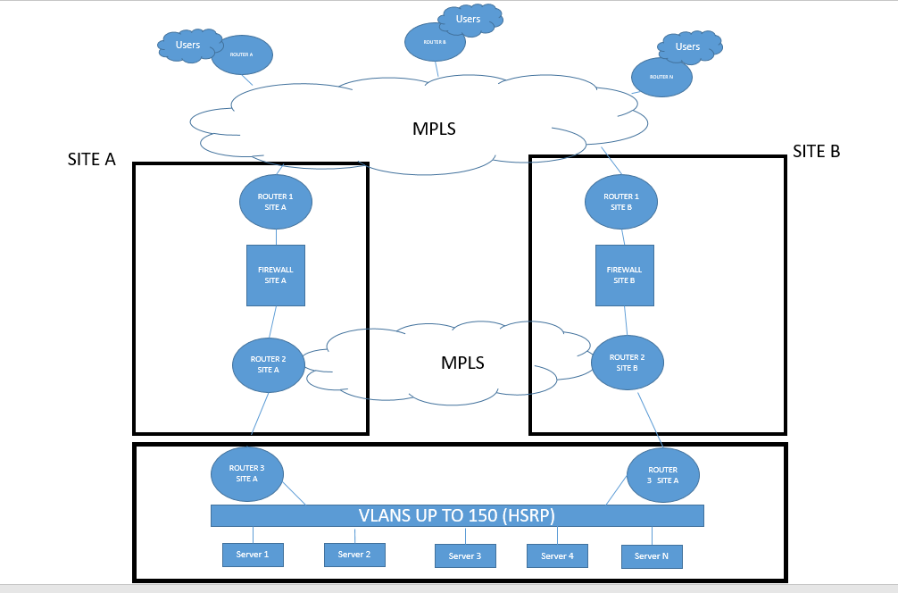

Dear Mates
I need your help with regard to a complex issue that I have inherited and now I need to provide solutions for it.
We have two geographically separated sites (represented as SITE A and SITE B), and on both Sites, we are running Check Point Firewalls. Each Firewall is connected to a Router (ROUTER 1 - SITE A, and ROUTER 1 - SITE B). The two routers are then connected to other Routers in the user space through our MPLS network.
Below the Firewalls, there are another routers (ROUTER 2 - SITE A, and ROUTER 2 - SITE B), these two routers also know each other through our internal MPLS network.
Below the two routers (ROUTER 2 - SITE A, and ROUTER 2 - SITE B), there is our Datacenter where all our servers reside.
ROUTER 2 - SITE A has the default route pointing to FIREWAAL SITE A
ROUTER 2 - SITE B has the default route pointing to FIREWAAL SITE B
The issue that we are currently facing is that when our users (offices, Stores, etc) access our servers in the Datacenter, the traffic to the server can get in through SITE A, and the return traffic from the server can go back through the Firewall on SITE B on its way back to the User who requested it. Unfortunately, the traffic gets dropped because it did not get in from the Firewall in SITE B.
This issue is happens because Servers in our Datacenter have different default gateways (some have default gateway to SITE A, and others to SITE B)
I would like get your contribution based on your experience on possible solution to solve this problem. Your help will be appreciated.
Thanks

Hi All
Thanks for your contribution. I wish to share some more information with regards to this issue.
One of the possible solutions to this issue is to use routing protocols as already mentioned above. The figure bellow highlights what we wish to achieve. However, apparently there is a limitation in Check Point when it comes to redistribution routesto specific interfaces, instead it redistributes the routes to all information. Is this information about redistribution true? if now, how can one ensure that routes are only advertised on specific interfaces instead of on all interfaces.
Thanks

Can't agree more, either go with HA site approach so you have a primary and backup sites or stretch L2 and make firewalls part of cross-site load sharing cluster.
Or "learn" each server's default gateway and have path statically configured on R1

This is a rather hard one and I don´t think a solution can be provided just over Checkmates, You have several routing possibilities and probably the solution will require architecture changes.
One solution is Source NAT on the LAN SIDE of the firewall but this I would not recommend as it is just a workaround to an actual bigger issue and could also have other impacts that I cannot access just by this design.
What kind of Routing protocols and where are they applied? if OSPF is being used I believe  we need Areas to be reflected on the design so we can understand what happens in terms of routing databases.
Are the Servers  organized in network ranges? can we combine all servers with the Same default gateways into a subnet?
Can you share some more detailed information the routing configuration of all devices?

The only way to solve this is by using Dynamic routing and have the 2 routers-1 divide the user sites to split the load and this way by giving a better path for remote site 1 via path A and a better path for remotes site 4 via path B.
I know it can be done with routers to get preferences set this way, don't know how to do it though.
In the router 3 layer you will need to allow a vlan for the routing to be able to make sure it can get back to router-2 in site B when router 3 sete A is the HSRP master.
Another method would be to flip it around and set priority for specific server VLANs via the site B and for other VLANs via site A. This will also simplify the issue a bit more as you also set HSRP to the site with the priority route.
Regards, Maarten

You don't want to not redistribute specific routes, you should only have a difference in weight/priority which should be defined in the Router 3 level.
This way if either of the 2 site paths is interrupted it will still know how to get to the servers.
Regards, Maarten

Hi Maarten Sjouw
Can I make the firewalls announce the network ranges with priority on each site using OSPF? or we can only achieve this at Router 3 level.
Thanks in advance

You should only do this on the Router 3 level, run OSPF from top to bottom and start at the beginning to make sure to accept and forward the weight of the routes through the whole path.
Make sure to set the weight of the mpls link between routers 2 at a uninteresting level, so the traffic will always take the route straight up/down, preventing the return traffic from router 3 Site B to take the MPLS path back to Site A again.
An alternative way to accomplish this, when you do not want to mess with Dynamic routing, is making use of tracking in the routers and statics based on tracking also here you need to have a second static that will take over when the tracking fails. Be sure to not set the tracking times to short.

What Maartens is saying I would just add:
If you run OSPF only UP - DOWN on both A and B sides and have the mpls Link with lower priority like already stated you should be able to make sure that preferred routes are always in the same side.
It could help to have 2 areas, running zero between Router 1 and 2 for example and running different  area for the firewall to avoid having loops with the IBGP link if the area 0 gets broken.
One thing I would definitely do is use TAGS to identify traffic from side A and Side B. This should help you troubleshoot since you can identify origin of routes by the tag.
Be sure to test all redundant scenarios after to make sure there is no flaw on the design, this has allot of possibilities and possibly we are not seeing all variables.

Well there are three ways to deal with this asymmetry:
1) While this asymmetric routing situation can be made to work by disabling the "Drop out of state TCP packets" checkbox under Stateful Inspection in Global Properties, this will defeat a major security feature of Check Point firewalls and the asymmetric flow of packets can cause some really odd-looking performance issues if one of the paths (A vs. B) gets heavily congested.
2) While not ideal, you can force symmetry in this situation regardless of the server's default gateway by performing a Hide NAT on the inbound traffic from the offices/stores behind the INTERNAL interface IP of the firewall.  So if the offices/stores traffic comes in through Firewall A, prior to leaving Firewall A the source IP is NATted to the INSIDE IP address of Firewall A.  The return traffic will come back to Firewall A regardless of what the server's default gateway is.  If the offices/stores traffic comes in through Firewall B, prior to leaving Firewall B the source IP is NATted to the inside IP address of Firewall B.  This will force the symmetry you desire with the following impacts:
  • Use of Hide NAT assumes that connections are initiated from the offices/stores to the servers at the bottom of your diagram.
  • If there are any kind of ACLs on Router2/Router3/Servers leveraging certain source IP addresses for access control, those will no longer work because all traffic from the offices/stores will look like it is coming from a single IP address, that of the firewall's inside interface.
  • Extra overhead will be incurred on the firewall to perform these NAT operations, and if there are a very large number of connections from all the offices/stores to a particular server destination IP address, there is a 50k concurrent connection limit per destination IP address when Hide NAT is involved that might get exceeded.
  • You'll probably need to use Manual NAT rules to obtain the granularity needed to make this work.
3) Use of OSPF as discussed previously - this will take much more planning and setup time but in the long run will give you a lot of extra flexibility to automatically deal with full or partial site failures, and even allow some load-sharing & balancing of traffic between the two sites.

Thank you very much. The second option which was also suggested by Ricardo Gros seems to be a quick win, and to overcome the 50k limitation, I can follow the Manual NAT configuration described in your book and mentioned above.
Once again Thank you.

Right, just wanted to mention the NAT approach again but also include the limitations you might run into.  Good luck!

As long as you are hiding it behind the actual internal firewall LAN IP (or CIP/VIP), no you don't need a proxy ARP.  If you are plucking an arbitrary address from that internal VLAN and hiding behind that one via a manual NAT rule then yes you will need a proxy ARP entry for it.
