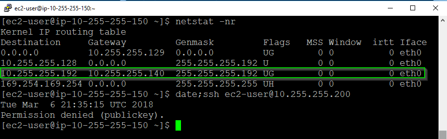

I've been asked an interesting and, seemingly, trivial question: "How would you protect the hosts in AWS VPC located in a different subnets by inspecting traffic between them?"
I was also assured that presently, AWS did not have a solution to this problem, as every routing table you create will contain "local" route, all traffic from all subnets within one VPC will be routed through it.
To work on this puzzle, this lab environment was provisioned:
...and answer to this dilemma is to use static routes in the instances pointing to the interfaces of the vSEC or cluster, as well as security groups as Sources fro the traffic to the Private Subnets:

[root@ip-10-255-255-150 ec2-user]# route
Kernel IP routing table
Destination Gateway Genmask Flags Metric Ref Use Iface
default 10.255.255.129 0.0.0.0 UG 0 0 0 eth0
10.255.255.128 * 255.255.255.192 U 0 0 0 eth0
10.255.255.192 10.255.255.140 255.255.255.192 UG 0 0 0 eth0
169.254.169.254 * 255.255.255.255 UH 0 0 0 eth0

[ec2-user@ip-10-255-255-150 ~]$ date; ssh 10.255.255.200
Fri Feb 16 13:29:42 UTC 2018
Permission denied (publickey).

The addition of the static routes could be either bootstrapped or included in AMIs, depending on your situation.
To verify that the instances residing in different subnets will remain isolated in the absence of the static routes, those were removed and we can see that the SSH connection attempt is timing out:

And reinstatement of the static routes results in:
[root@ip-10-255-255-150 ec2-user]# nano /etc/sysconfig/network-scripts/route-eth0
[root@ip-10-255-255-150 ec2-user]# reboot
Broadcast message from ec2-user@ip-10-255-255-150
(/dev/pts/0) at 16:54 ...
The system is going down for reboot NOW!
Using username "ec2-user".
Authenticating with public key "imported-openssh-key"
Last login: Fri Feb 16 16:42:28 2018 from xx.xx.xxx.98
__| __|_ )
_| ( / Amazon Linux AMI
___|\___|___|
https://aws.amazon.com/amazon-linux-ami/2017.09-release-notes/
[ec2-user@ip-10-255-255-150 ~]$ ssh ec2-user@10.255.255.200

I am setting this environment up right now. Does the host need to have public temp IP? I am assuming no, correct?
If you are talking about EC2 instances, they do not have to have public IPs.
The reason for those in my lab was to gain the remote access to them bypassing vSEC for simplicity and to avoid a lockout should I bork something in the policy.
Got it. What is the purpose of the 169.254.169.254 address in the route table?
That's the AWS' metadata lookup IP.
the big issue that i would have is that the routing is now back in the hands of the sysadmin... if they modify the routing they could bypass the gw no?
I appreciate the help. I am having trouble setting up this lab config. I don't believe my subnets are even going through the GW at all. Below are screenshots that I have configured. I would love to have this setup to show to our partners so any help is appreciated:
Web Server 1:
Web Server 2:
GW:
Policy:
NAT:
I'm looking into it.
Can you confirm that you have at least Internet access through the vSEC from the hosts?
Would you mind dropping the vSEC's gaia config as well?
Certainly.
I checked and I cannot go outbound from the host to Internet. I can access the Internet from CloudGuard GW. I suspect that I screwed up somewhere with the routing, but at the moment, I am in need of some fresh eyes.

Let's try to figure it out.
1. set interface eth0 ipv4-address 10.255.255.45 mask-length 26
add interface eth0 alias 54.176.229.227/32
I suspect that this line is in error, since you are assigning AWS EIP to the 10.255.255.45. I am not sure what having the alias assigned to the interface will do in AWS environment, but rough logic is that the public IP is actually assigned to the IGW and your EIP association created a static NAT entry in it that is pointing it to your vSEC's external interface.
If you have another identical address assigned to the vSEC, it may cause hmm.. some issues.
2. One of the internal legs of your vSEC is acquiring IP from DHCP... :
add dhcp client interface eth2
set dhcp client interface eth2 timeout 60
set dhcp client interface eth2 retry 300
set dhcp client interface eth2 reboot 10
As such, it may cause inheritance of the routing data from AWS' VPC default router.
It is hard for me to decipher all of the implications of this without prolonged meditation session, but I am in favor of not doing it quite yet (at least until you'll get the rest of the things working).
But as this solution is relying on static routes on hosts pointing to correct and, supposedly, fixed IP of the vSEC's interface, unless you've implemented some-kind of additional logic on hosts to adjust the routing dynamically, let's stick with static IPs.
And I cannot refrain from asking the equivalent of "have you plugged it in?" question:
Are you positive that your vSEC and the hosts are in the same region?

Hi Vladimir,
Thank you for your help. Unfortunately, even after trying the 3 steps above, my setup still does not work.
However, I believe I know what the problem is. For some reason, I cannot ping from Web Server 2 to the CloudGuard GW interface that leads to Web Server 1 (eth1). Ping succeeds from Web Server 2 to CloudGuard GW interface eth2, but for some reason fails on eth2.
10.255.255.141 is Web Server 2 trying to ping eth1 of CloudGuard GW.
10.255.255.142 is eth2 of CloudGuard GW. As you can see. Pinging within the same subnet range (10.255.255.128/26) works.
Odd part is that Web Server 1 is able to ping to both eth1 and eth2 of CloudGuard GW.

I have verified that the above configuration matches mine.
Can you post the screenshots of your security groups and routing tables as well as verify that the Net_10.255.255.XX objects configured correctly?
Their names look right, but the actual networks assigned to them are in question.
