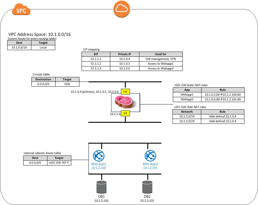

Sal, on the routing table attached to the subnet of the internal server, the default route has to point to the internal interface (eth1) of the vSEC gateway, and not to the internet gateway.
For the subnet of eth0 of the vSEC gateway, the attached routing table should point to the the internet gateway.
See the attached drawing.
We have our built just like this except for the subnets are different.

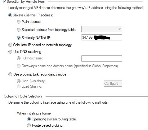

Next make sure in smartconsole-> gw properties->vpn->link selection, that the gateway is set to be behind NAT with the right ip address, ie, the EIP associated with the address of eth0.

2) Yes, both are set to the EIP assigned to eth0 on the device.

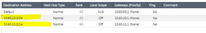

Based on your reply I updated the routing table with 2 new entries.
Now lets say my corporate office we are connected to via VPN has an IP range of 10.10.0.0/24, I can ping a server in that IP space now. But I cannot ping a server by name, even though the DNS of the AWS instance is set to the IP address of the server on the corporate side. I also cannot get out to the internet on the server in AWS.
The server at the corporate office can ping the AWS server by name, and by IP.
When I go to change the Network interface 2 issues. Spoofing is going crazy, i just set it to detect, and In order for all this to work, I have to set both interfaces to Internal, which is not true. I have messed around with all types of combinations, eth0, External, goes to DMZ, Internal, Goes to DMZ, etc etc... nothing really works well and none really get rid of the spoofing alerts, even when I exclude all the subnets in the "Don't check these subnets", which I can only do when it is set to Internal.
So now what?
The reality is that your eth1 interface should have a route for all the subnets in your VPC (even ones you're not using).
Assuming your VPC is 10.60/16, a single route on the vSEC instance to 10.60.10.1 should cover current and future subnets.
Your existing route to 10.60.11/24 won't work because the next hop should be 10.60.10.1.
